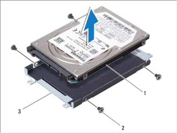

    • Remove the four screws that secure the hard drive assembly to the computer base.
    • Using the pull-tab, slide the hard drive towards the left to disconnect the hard drive assembly from the connector on the system board.
    • Lift the hard drive assembly out of the computer base.
    • Remove the four screws that secure the hard drive cage to the hard drive.

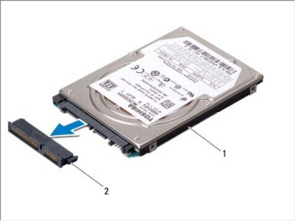

    • Pull the interposer to disconnect it from the hard drive.
    • Lift the hard drive off the hard drive cage.
