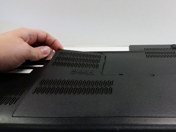

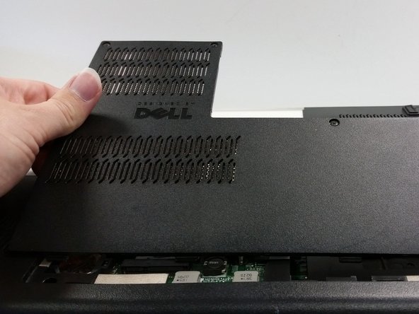

  5. Dell Studio 1558 Motherboard Replacement, Motherboard: crwdns2935265:05crwdnd2935265:01crwdnd2935265:03crwdne2935265:0 Dell Studio 1558 Motherboard Replacement, Motherboard: crwdns2935265:05crwdnd2935265:02crwdnd2935265:03crwdne2935265:0 Dell Studio 1558 Motherboard Replacement, Motherboard: crwdns2935265:05crwdnd2935265:03crwdnd2935265:03crwdne2935265:0
    • Make sure the battery is properly removed. If not, you could experience shocks.

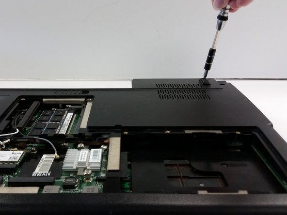

    • Unscrew the three screws (Phillips #0) on the back panel to reveal the innards underneath the panel. It is helpful to keep these screws in the holes of the back panel.
    • Pry the back panel off and set aside.
    • A little bit of force may be necessary in removing the panel as there are some minor plastic clips holding the panel in place in addition to the screws.

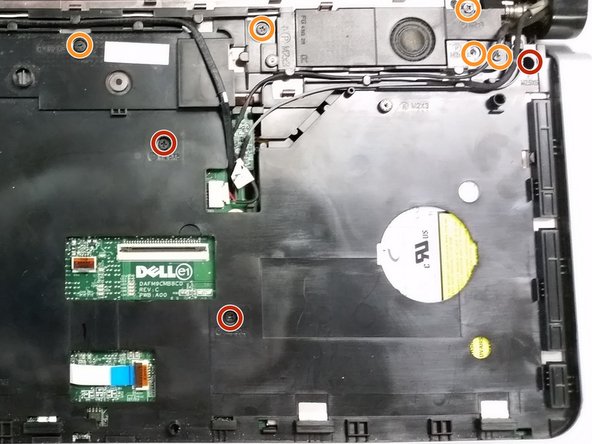

  6. Dell Studio 1558 Motherboard Replacement: crwdns2935265:06crwdnd2935265:01crwdnd2935265:02crwdne2935265:0 Dell Studio 1558 Motherboard Replacement: crwdns2935265:06crwdnd2935265:02crwdnd2935265:02crwdne2935265:0
    • Remove the visible screws with a Phillips #0 screwdriver.
    • Note that there are a couple different types of screws, so you might want to organize them, unless you love confusion.
    • There are six regular screws.
    • There is one screw marked M 2X3 .

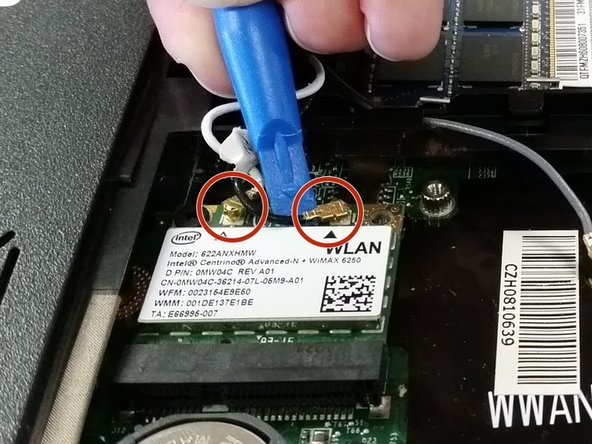

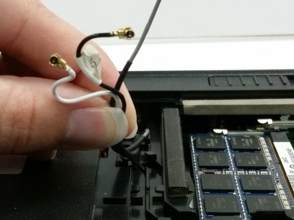

    • Disconnect the WLAN (Wi-Fi) antenna cables.
    • These cables connect like button snaps, so just unsnap them by tugging lightly or gently prying them up away from the WLAN card.
    • Gather the antenna cables (black, white, and grey) and unwind them from the clips they are pinned under to keep them from rattling around.
    • The grey cable may be attached or unattached to the WLAN card depending on the number of antenna cables your card supports.

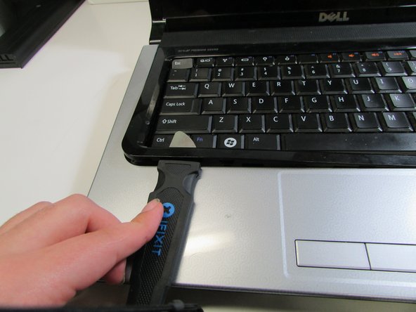

    • Now flip the laptop over and open it up.
    • Insert a pry tool under the black plastic guard around the edge of the keyboard and pry the guard up. Plastic snaps are holding the guard in place.
    • You can also do this with your hands once you have enough pried up, but keep in mind that the plastic is thin and capable of breaking if bent too far.
    • Place the keyboard guard in a safe location out of harm's way.

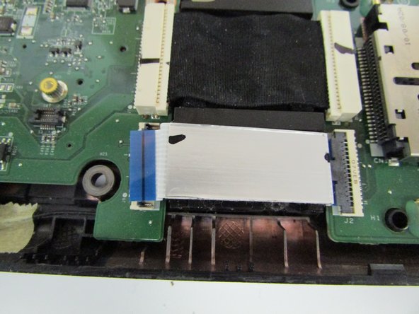

    • Let's undo some cables!
    • Disconnect the ribbon from the ZIF (Zero Insertion Force) connector by flipping up the small black flap with a spudger or fingernail and removing the cable using the blue tab to pull away.
    • Undo both bundled cable connectors by pulling collectively on the wires and helping it along with a spudger to disconnect.
    • Once the cables are disconnected, unthread the cables from their grooved paths in the upper housing.

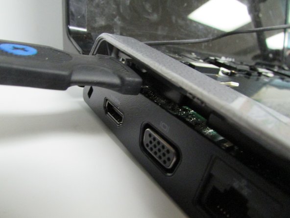

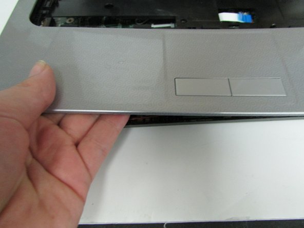

    • Now, to remove the rest of the upper casing (the silver part which includes the touchpad).
    • This step is going to take a little strength and a lot of patience.
    • Take the flat edge of a pry tool and slip it between the upper and lower casings.
    • The silver and black upper panel (which held/surrounded the keyboard) is meant to be removed as one piece. Try to avoid pulling up only the silver portion as it will damage the plastic pins holding it in place.
    • Pry the upper casing up with the pry tool. You will hear some snaps as it comes loose. Those are supposed to happen.
    • Once you got enough lifted up, you can take your hand and pry it up that way.
    • If a part of the case is being very stubborn, double check to make sure any screws have not been forgotten.

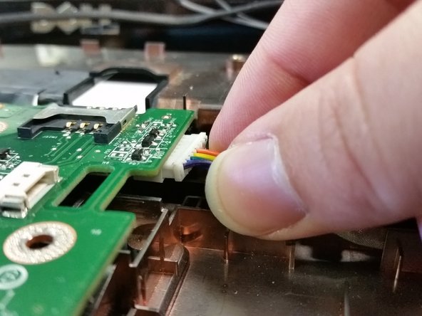

    • Disconnect any visible cables that you can spot and access.
    • There are five bundled cables that you can removed by gently tugging on the gathered wires as you assist it's exit with a spudger.
    • Disconnect the ZIF connector by flipping up the black flap with a fingernail or spudger and then pulling the ribbon cable away.

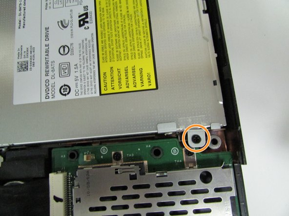

  16. Dell Studio 1558 Motherboard Replacement: crwdns2935265:016crwdnd2935265:01crwdnd2935265:03crwdne2935265:0 Dell Studio 1558 Motherboard Replacement: crwdns2935265:016crwdnd2935265:02crwdnd2935265:03crwdne2935265:0 Dell Studio 1558 Motherboard Replacement: crwdns2935265:016crwdnd2935265:03crwdnd2935265:03crwdne2935265:0

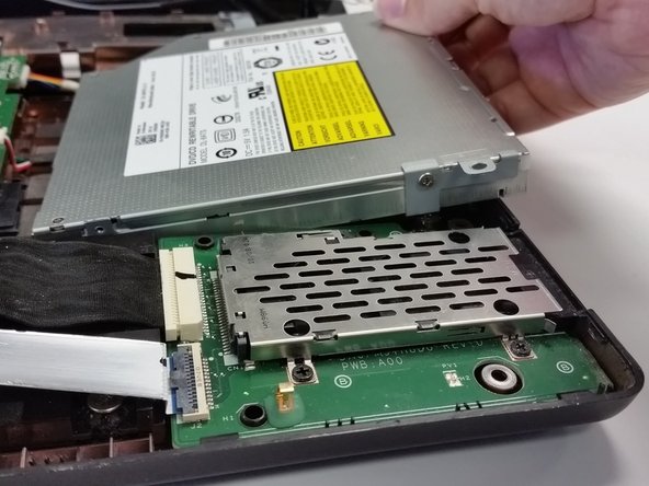

    • The next step will be to remove the CD/DVD drive from the laptop.
    • Unscrew the two silver screws attached to the motherboard.
    • Then unscrew the black screw attaching it to the motherboard close to the outer edge of the laptop.
    • Lift the CD ROM slightly, and disengage it from the motherboard.

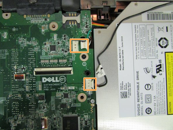

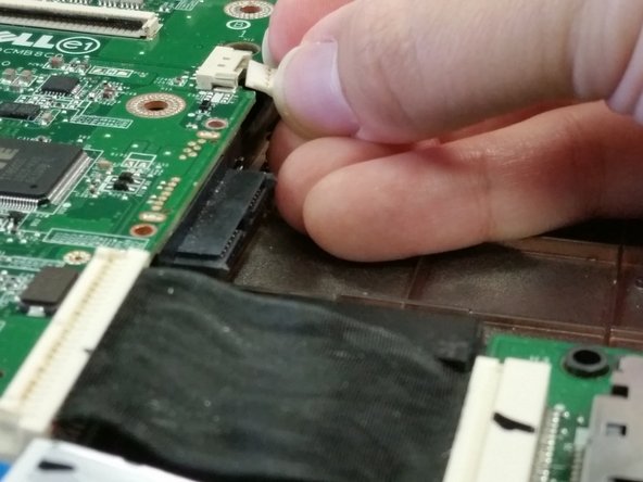

    • Disconnect two more bundled cables you're now able to access with the CD/DVD drive removed.

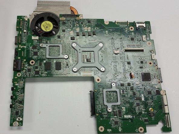

    • Lift the motherboard up and out of the case and set the case aside.
    • This should be really simple. If it is a struggle to lift the motherboard out, then there might be a forgotten screw, or a ribbon still connected.
