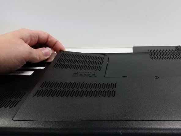

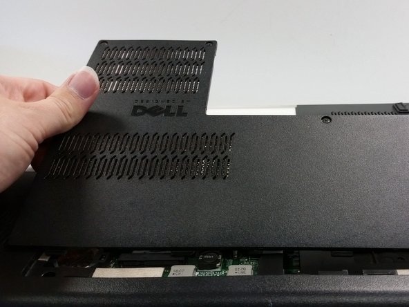

    • Make sure the battery is properly removed. If not, you could experience shocks.
    • Unscrew the three screws (Phillips #0) on the back panel to reveal the innards underneath the panel. It is helpful to keep these screws in the holes of the back panel.
    • Pry the back panel off and set aside.
    • A little bit of force may be necessary in removing the panel as there are some minor plastic clips holding the panel in place in addition to the screws.

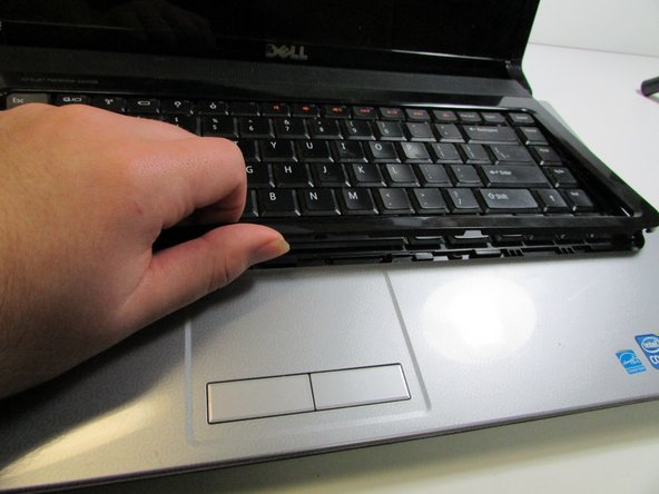

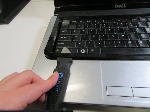

    • Now flip the laptop over and open it up.
    • Insert a pry tool under the black plastic guard around the edge of the keyboard and pry the guard up. Plastic snaps are holding the guard in place.
    • You can also do this with your hands once you have enough pried up, but keep in mind that the plastic is thin and capable of breaking if bent too far.
    • Place the keyboard guard in a safe location out of harm's way.

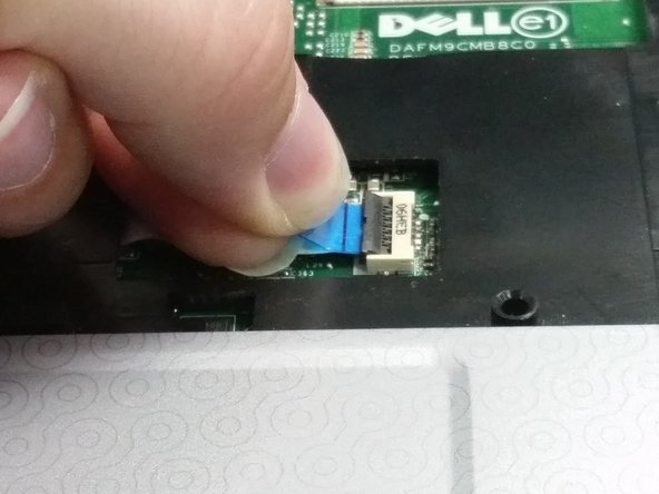

    • Let's undo some cables!
    • Disconnect the ribbon from the ZIF (Zero Insertion Force) connector by flipping up the small black flap with a spudger or fingernail and removing the cable using the blue tab to pull away.
    • Undo both bundled cable connectors by pulling collectively on the wires and helping it along with a spudger to disconnect.
    • Once the cables are disconnected, unthread the cables from their grooved paths in the upper housing.

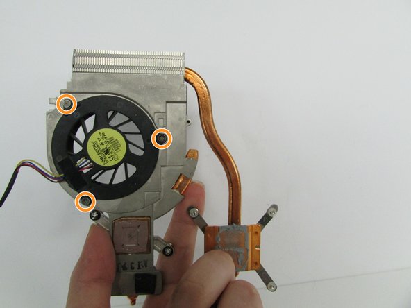

  20. Dell Studio 1558 Fan Replacement: crwdns2935265:020crwdnd2935265:01crwdnd2935265:02crwdne2935265:0 Dell Studio 1558 Fan Replacement: crwdns2935265:020crwdnd2935265:02crwdnd2935265:02crwdne2935265:0
    • In order to completely remove the fan you will need to remove the heat sink from the motherboard.
    • Unscrew the six silver screws that attach the fan casing to the motherboard.
    • Gently pull up the square portion of the copper piping as that covers the processor.
    • When reassembling, it's best practice to properly reapply a thermal paste between the heat sink/pipes and the processor after cleaning the old paste off; failure to do this could cause your processor to overheat, making your computer sluggish, and eventually fail. (You can find other guides on iFixit for how to apply/remove thermal paste.)
  21. Dell Studio 1558 Fan Replacement: crwdns2935265:021crwdnd2935265:01crwdnd2935265:03crwdne2935265:0 Dell Studio 1558 Fan Replacement: crwdns2935265:021crwdnd2935265:02crwdnd2935265:03crwdne2935265:0 Dell Studio 1558 Fan Replacement: crwdns2935265:021crwdnd2935265:03crwdnd2935265:03crwdne2935265:0
    • Undo the cable connector buy pulling firmly on all of the gathered cables together and away from the board.
    • At this point, most fan replacements include the casing that surrounds the fan.
    • If necessary (depending on the part purchased) remove the three screws on the back (two black and one silver). With these screws removed the fan itself should fall right out of the heat sink.
