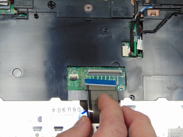

    4. Dell Studio 1555 Keyboard Replacement: crwdns2935265:07crwdnd2935265:01crwdnd2935265:01crwdne2935265:0
      • Slowly lift the keyboard away from the base.
      • If you pull to hard you risk breaking the keyboard cable connector from the motherboard.
    5. Dell Studio 1555 Keyboard Replacement: crwdns2935265:08crwdnd2935265:01crwdnd2935265:03crwdne2935265:0 Dell Studio 1555 Keyboard Replacement: crwdns2935265:08crwdnd2935265:02crwdnd2935265:03crwdne2935265:0 Dell Studio 1555 Keyboard Replacement: crwdns2935265:08crwdnd2935265:03crwdnd2935265:03crwdne2935265:0

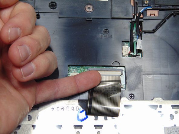

      • Flip up the black tab on the keyboard ZIF connector and unplug the cable.
    6. Dell Studio 1555 Keyboard Replacement: crwdns2935265:09crwdnd2935265:01crwdnd2935265:01crwdne2935265:0
      • Remove the keyboard
