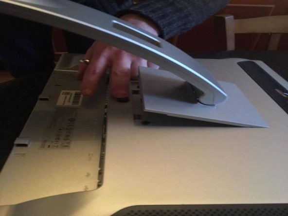

    • The front panel is now completely unclipped, put the screen (screen side) against the table, being careful not to re-clip the front panel, then remove the support/stand from the screen.

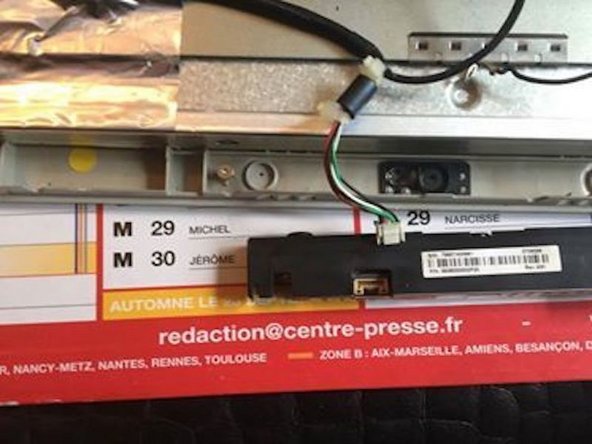

  8. Dell SP2208WFT Capacitor Replacement: crwdns2935265:08crwdnd2935265:01crwdnd2935265:02crwdne2935265:0 Dell SP2208WFT Capacitor Replacement: crwdns2935265:08crwdnd2935265:02crwdnd2935265:02crwdne2935265:0
    • Disconnect the various connectors, take the small Phillips screwdriver, remove the webcam and disconnect it.

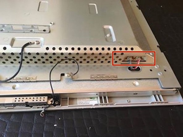

  9. Dell SP2208WFT Capacitor Replacement: crwdns2935265:09crwdnd2935265:01crwdnd2935265:03crwdne2935265:0 Dell SP2208WFT Capacitor Replacement: crwdns2935265:09crwdnd2935265:02crwdnd2935265:03crwdne2935265:0 Dell SP2208WFT Capacitor Replacement: crwdns2935265:09crwdnd2935265:03crwdnd2935265:03crwdne2935265:0
    • Disconnect the USB hub, the cable and the other connector of the webcam cable.

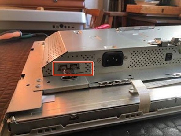

    • You also have four other connectors to disconnect located on the top and bottom right as in the photo.

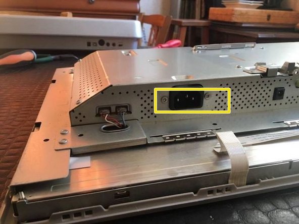

  10. Dell SP2208WFT Capacitor Replacement: crwdns2935265:010crwdnd2935265:01crwdnd2935265:02crwdne2935265:0 Dell SP2208WFT Capacitor Replacement: crwdns2935265:010crwdnd2935265:02crwdnd2935265:02crwdne2935265:0
    • Remove the screws from the power socket of the HDMI, VGA and DVI ports if there are any.

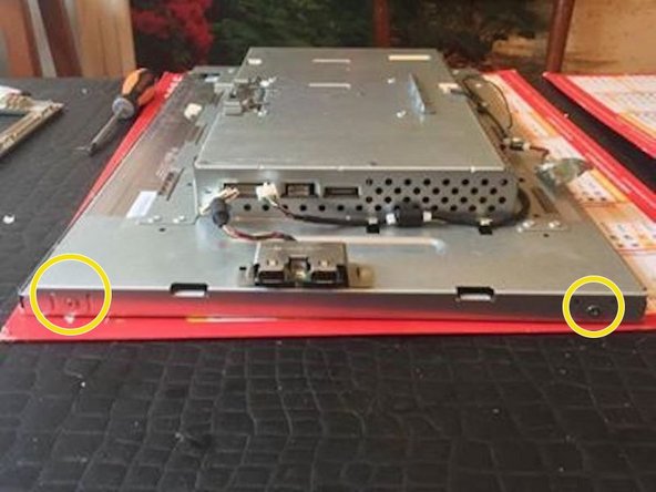

  11. Dell SP2208WFT Capacitor Replacement: crwdns2935265:011crwdnd2935265:01crwdnd2935265:02crwdne2935265:0 Dell SP2208WFT Capacitor Replacement: crwdns2935265:011crwdnd2935265:02crwdnd2935265:02crwdne2935265:0
    • On each side, on the side of the screen, you have 2 screws, or 4 in total, remove them.

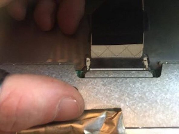

  13. Dell SP2208WFT Capacitor Replacement: crwdns2935265:013crwdnd2935265:01crwdnd2935265:02crwdne2935265:0 Dell SP2208WFT Capacitor Replacement: crwdns2935265:013crwdnd2935265:02crwdnd2935265:02crwdne2935265:0
    • Between the metal cover and the screen, the video cable must be disconnected. Press on each side of the tablecloth towards the center of the tablecloth, and push down the screen to remove the tablecloth.
    • You won't get it right the first time, take your time.

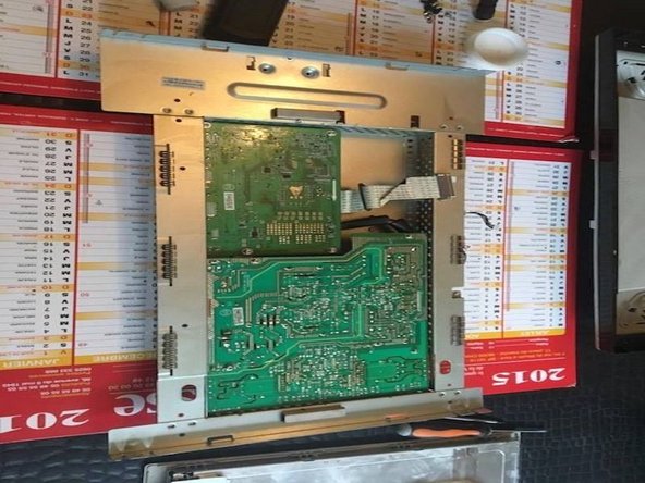

  15. Dell SP2208WFT Capacitor Replacement, Removal of the first electronic card: crwdns2935265:015crwdnd2935265:01crwdnd2935265:01crwdne2935265:0
    • Take the metal cover.
    • Remove the 4 screws from the smaller of the 2 electronic cards (video card).
    • Unplug the only connected slot.
  16. Dell SP2208WFT Capacitor Replacement, Removing the second electronic board: crwdns2935265:016crwdnd2935265:01crwdnd2935265:01crwdne2935265:0
    • You can now remove the screws from the other electronic board (power board)

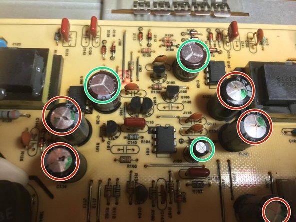

    • First, you must IDENTIFY the faulty capacitors... How? In this specific case, nothing could be simpler, since the capacitor was subjected to a temperature exceeding 105°C inside the screen, it burst.
    • When the screen is on for several hours, the cards are poorly ventilated with the fact that these capacitors are placed next to or too close to a heat sink. But be careful, this is not a general rule for testing a capacitor.

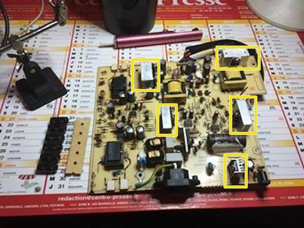

  17. Dell SP2208WFT Capacitor Replacement: crwdns2935265:018crwdnd2935265:01crwdnd2935265:03crwdne2935265:0 Dell SP2208WFT Capacitor Replacement: crwdns2935265:018crwdnd2935265:02crwdnd2935265:03crwdne2935265:0 Dell SP2208WFT Capacitor Replacement: crwdns2935265:018crwdnd2935265:03crwdnd2935265:03crwdne2935265:0
    • If the top of the capacitor is not flat, it is bad. Example in photo circled in red.
    • the functional capacitor is in green circles.
    • the heat sinks are in the yellow circles.
