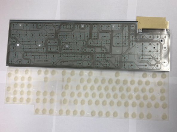

  2. Dell Quietkey SK-8000 Keyboard Teardown: crwdns2935265:02crwdnd2935265:01crwdnd2935265:02crwdne2935265:0 Dell Quietkey SK-8000 Keyboard Teardown: crwdns2935265:02crwdnd2935265:02crwdnd2935265:02crwdne2935265:0
    • Lift the keyboard upward from the bottom.
    • Do not pull too hard when lifting the base. Be careful not to destroy the wires connecting to the base of the keyboard.
    • Use a Phillips screwdriver to remove the remaining ten screws on the aluminum plate.

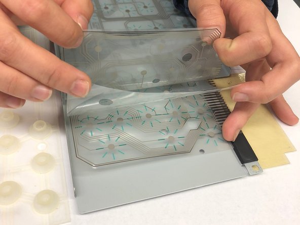

  3. Dell Quietkey SK-8000 Keyboard Teardown, Completion: crwdns2935265:03crwdnd2935265:01crwdnd2935265:03crwdne2935265:0 Dell Quietkey SK-8000 Keyboard Teardown, Completion: crwdns2935265:03crwdnd2935265:02crwdnd2935265:03crwdne2935265:0 Dell Quietkey SK-8000 Keyboard Teardown, Completion: crwdns2935265:03crwdnd2935265:03crwdnd2935265:03crwdne2935265:0
    • Carefully lift each part out. Each part should lift out very easily after the screws are removed.
  4. Dell Quietkey SK-8000 Keyboard Teardown, Siltek Chip Reveal: crwdns2935265:04crwdnd2935265:01crwdnd2935265:01crwdne2935265:0
    • The keyboard controller is seen to be a Siltek R4462.
