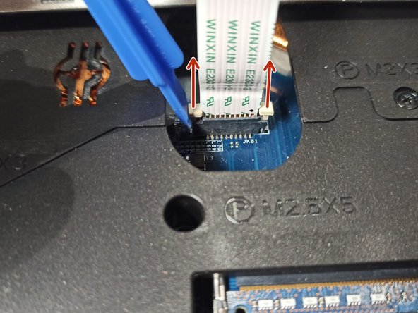

  7. Dell Precision M6800 Keyboard Replacement: crwdns2935265:07crwdnd2935265:01crwdnd2935265:02crwdne2935265:0 Dell Precision M6800 Keyboard Replacement: crwdns2935265:07crwdnd2935265:02crwdnd2935265:02crwdne2935265:0
    • Pry up the white part of connector (constant for both sides) and eject connecting flex

Broke off the stupid white clip holding the connector in place go to h ell
