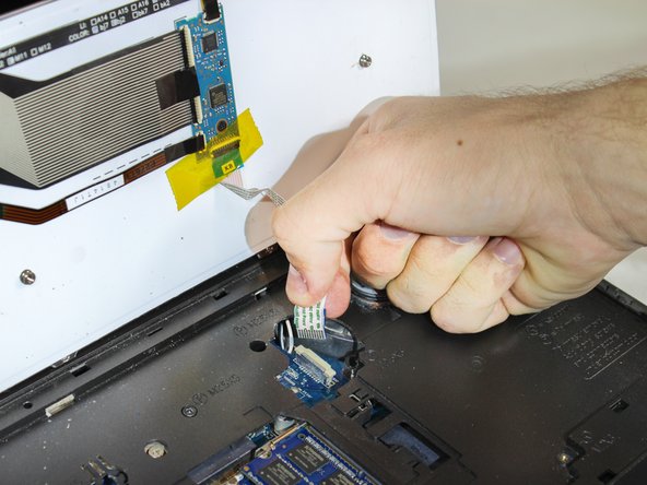

  7. Dell Precision M4800 Four Slot RAM Replacement: crwdns2935265:07crwdnd2935265:01crwdnd2935265:02crwdne2935265:0 Dell Precision M4800 Four Slot RAM Replacement: crwdns2935265:07crwdnd2935265:02crwdnd2935265:02crwdne2935265:0
    • Disconnect the ribbon connector that attaches the keyboard to the motherboard.
    • Remove the keyboard.

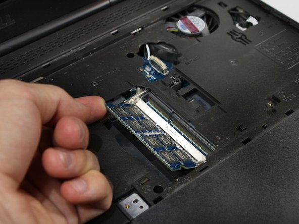

  8. Dell Precision M4800 Four Slot RAM Replacement: crwdns2935265:08crwdnd2935265:01crwdnd2935265:03crwdne2935265:0 Dell Precision M4800 Four Slot RAM Replacement: crwdns2935265:08crwdnd2935265:02crwdnd2935265:03crwdne2935265:0 Dell Precision M4800 Four Slot RAM Replacement: crwdns2935265:08crwdnd2935265:03crwdnd2935265:03crwdne2935265:0
    • Pull the retention clips away from the first RAM card simultaneously.
    • Lift the first RAM card upwards.
    • Pull the first RAM card away from the slot.
  9. Dell Precision M4800 Four Slot RAM Replacement: crwdns2935265:09crwdnd2935265:01crwdnd2935265:03crwdne2935265:0 Dell Precision M4800 Four Slot RAM Replacement: crwdns2935265:09crwdnd2935265:02crwdnd2935265:03crwdne2935265:0 Dell Precision M4800 Four Slot RAM Replacement: crwdns2935265:09crwdnd2935265:03crwdnd2935265:03crwdne2935265:0
    • Pull the retention clips away from the second RAM card simultaneously.
    • Lift the second RAM card upwards.
    • Pull the second RAM card away from the slot.
  10. Dell Precision M4800 Four Slot RAM Replacement: crwdns2935265:010crwdnd2935265:01crwdnd2935265:02crwdne2935265:0 Dell Precision M4800 Four Slot RAM Replacement: crwdns2935265:010crwdnd2935265:02crwdnd2935265:02crwdne2935265:0
    • Insert the first replacement RAM card into the slot at an angle.
    • The RAM card is keyed and will only go into the slot in one orientation.
    • Lightly press the RAM card into the computer.
    • Ensure the RAM card is seated properly. Both tabs should be secured to the RAM card's grooves.
  11. Dell Precision M4800 Four Slot RAM Replacement: crwdns2935265:011crwdnd2935265:01crwdnd2935265:02crwdne2935265:0 Dell Precision M4800 Four Slot RAM Replacement: crwdns2935265:011crwdnd2935265:02crwdnd2935265:02crwdne2935265:0
    • Insert the second replacement RAM card into the slot at an angle.
    • The RAM card is keyed and will only go into the slot at one orientation.
