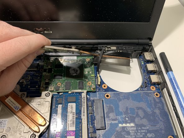

  15. Dell Precision M4700 Motherboard Replacement: crwdns2935265:015crwdnd2935265:01crwdnd2935265:02crwdne2935265:0 Dell Precision M4700 Motherboard Replacement: crwdns2935265:015crwdnd2935265:02crwdnd2935265:02crwdne2935265:0
    • Unscrew the four heatsink captive screws with a Phillips #00 screwdriver.
    • Pull the heatsink out.
    • Captive screws should not be able to be removed. They only screw they do not come out.
    • Be sure to clean both contact points on the GPU and heatsink with isopropyl alcohol and reapply fresh thermal paste before reinstalling the heatsink.

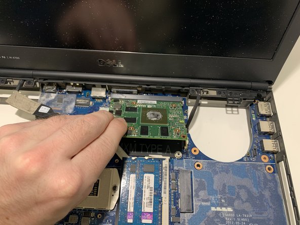

  16. Dell Precision M4700 Motherboard Replacement: crwdns2935265:016crwdnd2935265:01crwdnd2935265:02crwdne2935265:0 Dell Precision M4700 Motherboard Replacement: crwdns2935265:016crwdnd2935265:02crwdnd2935265:02crwdne2935265:0
    • Remove the two 4mm screws connecting the GPU to the device with a Phillips #00 screwdriver.
    • Remove the GPU by pulling it out away from the screen side.

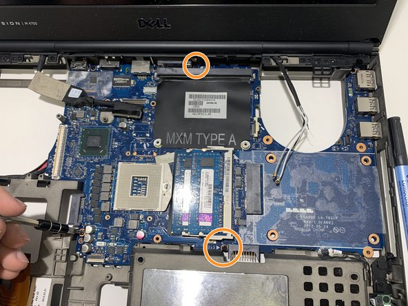

  18. Dell Precision M4700 Motherboard Replacement: crwdns2935265:018crwdnd2935265:01crwdnd2935265:02crwdne2935265:0 Dell Precision M4700 Motherboard Replacement: crwdns2935265:018crwdnd2935265:02crwdnd2935265:02crwdne2935265:0
    • Disconnect the wires connecting the CMOS battery to the device.
  19. Dell Precision M4700 Motherboard Replacement: crwdns2935265:019crwdnd2935265:01crwdnd2935265:03crwdne2935265:0 Dell Precision M4700 Motherboard Replacement: crwdns2935265:019crwdnd2935265:02crwdnd2935265:03crwdne2935265:0 Dell Precision M4700 Motherboard Replacement: crwdns2935265:019crwdnd2935265:03crwdnd2935265:03crwdne2935265:0
    • Disconnect the wires connecting the motherboard to the device.
    • The cables should be connected in three locations. Top right, top left and bottom right.
  20. Dell Precision M4700 Motherboard Replacement: crwdns2935265:020crwdnd2935265:01crwdnd2935265:03crwdne2935265:0 Dell Precision M4700 Motherboard Replacement: crwdns2935265:020crwdnd2935265:02crwdnd2935265:03crwdne2935265:0 Dell Precision M4700 Motherboard Replacement: crwdns2935265:020crwdnd2935265:03crwdnd2935265:03crwdne2935265:0
    • Remove four 5mm Phillips #00 screws connecting the motherboard to the frame of the device.
    • Remove two 3mm Phillips #00 screws connecting the motherboard to the frame of the device.

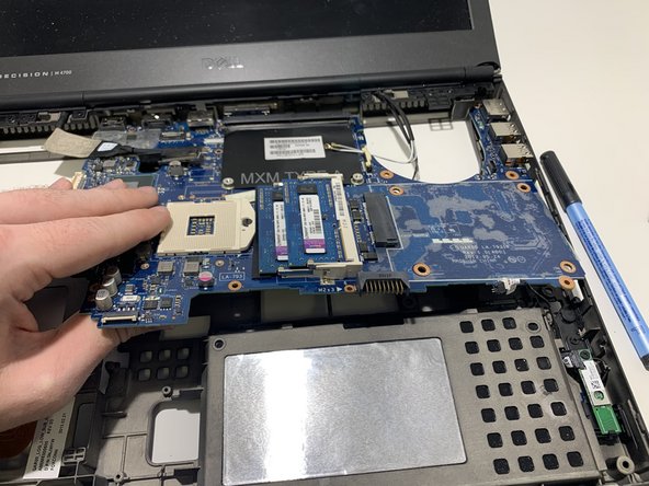

  21. Dell Precision M4700 Motherboard Replacement: crwdns2935265:021crwdnd2935265:01crwdnd2935265:02crwdne2935265:0 Dell Precision M4700 Motherboard Replacement: crwdns2935265:021crwdnd2935265:02crwdnd2935265:02crwdne2935265:0
    • Disconnect the wire connecting the motherboard to the frame of the device.
    • Remove the motherboard.
