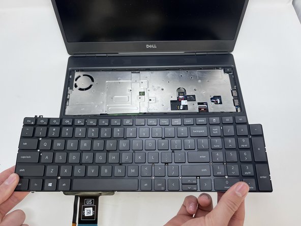

    • With the back cover and battery removed, locate the ribbon cables connected to the keyboard.
    • Pulling from the tab, carefully remove the connector.

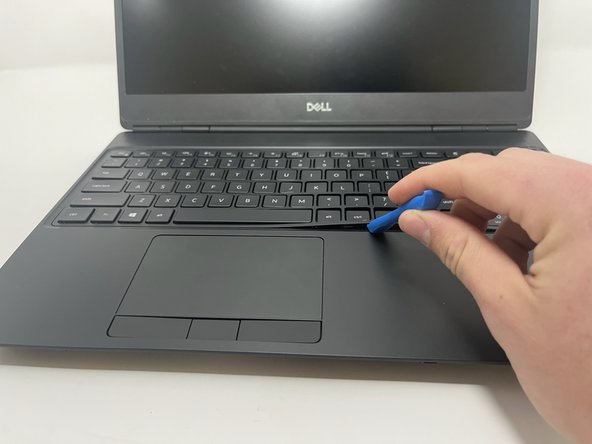

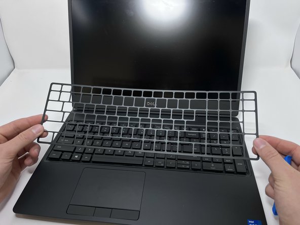

    • Turn the device over and open the screen to expose the keyboard.
    • Using an opener tool, pry along the edges of the keyboard to remove the keyboard's plate cover.

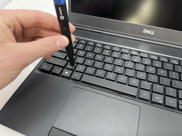

  6. Dell Precision 7560 Keyboard Replacement: crwdns2935265:06crwdnd2935265:01crwdnd2935265:03crwdne2935265:0 Dell Precision 7560 Keyboard Replacement: crwdns2935265:06crwdnd2935265:02crwdnd2935265:03crwdne2935265:0 Dell Precision 7560 Keyboard Replacement: crwdns2935265:06crwdnd2935265:03crwdnd2935265:03crwdne2935265:0
    • With the plate cover removed, use the screwdriver to remove each of the six 2 mm screws.
    • Carefully remove the keyboard from the device.
