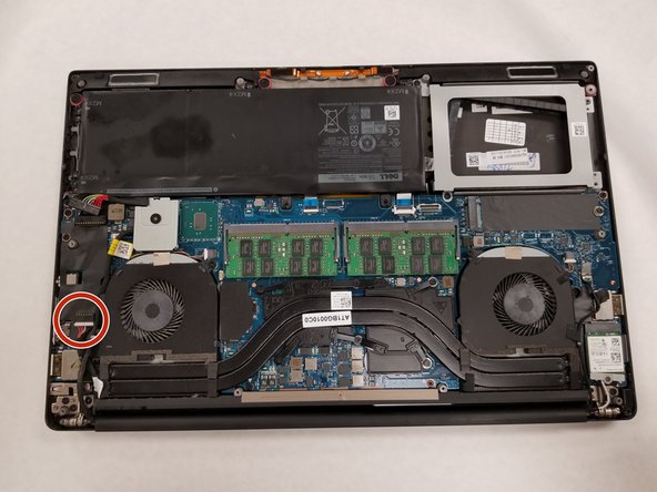

  3. Dell Precision 5510 Screen Replacement, Battery: crwdns2935265:03crwdnd2935265:01crwdnd2935265:02crwdne2935265:0 Dell Precision 5510 Screen Replacement, Battery: crwdns2935265:03crwdnd2935265:02crwdnd2935265:02crwdne2935265:0
    • Unplug the connection that links the battery to the computer.

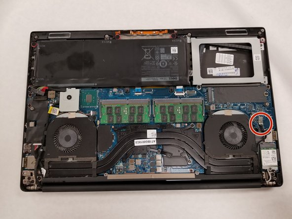

  5. Dell Precision 5510 Screen Replacement: crwdns2935265:05crwdnd2935265:01crwdnd2935265:02crwdne2935265:0 Dell Precision 5510 Screen Replacement: crwdns2935265:05crwdnd2935265:02crwdnd2935265:02crwdne2935265:0
    • Carefully remove the battery from the computer.

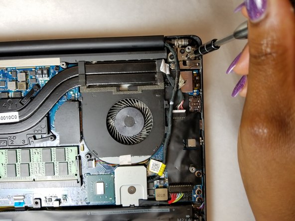

  6. Dell Precision 5510 Screen Replacement, Screen: crwdns2935265:06crwdnd2935265:01crwdnd2935265:02crwdne2935265:0 Dell Precision 5510 Screen Replacement, Screen: crwdns2935265:06crwdnd2935265:02crwdnd2935265:02crwdne2935265:0
    • Remove the six 4.0 mm Phillips #1 screws.

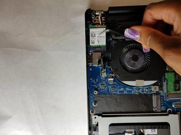

  7. Dell Precision 5510 Screen Replacement: crwdns2935265:07crwdnd2935265:01crwdnd2935265:02crwdne2935265:0 Dell Precision 5510 Screen Replacement: crwdns2935265:07crwdnd2935265:02crwdnd2935265:02crwdne2935265:0
    • Unscrew the one 4.0 mm Phillips #1 screw from the WiFi chip, then remove it.

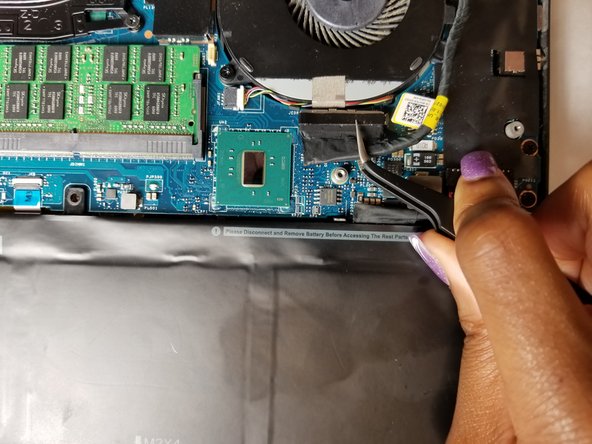

  8. Dell Precision 5510 Screen Replacement: crwdns2935265:08crwdnd2935265:01crwdnd2935265:02crwdne2935265:0 Dell Precision 5510 Screen Replacement: crwdns2935265:08crwdnd2935265:02crwdnd2935265:02crwdne2935265:0
    • Disconnect the black wire. Use tweezers to help.
  9. Dell Precision 5510 Screen Replacement: crwdns2935265:09crwdnd2935265:01crwdnd2935265:02crwdne2935265:0 Dell Precision 5510 Screen Replacement: crwdns2935265:09crwdnd2935265:02crwdnd2935265:02crwdne2935265:0
    • Disconnect the multi wire. Use tweezers to help.

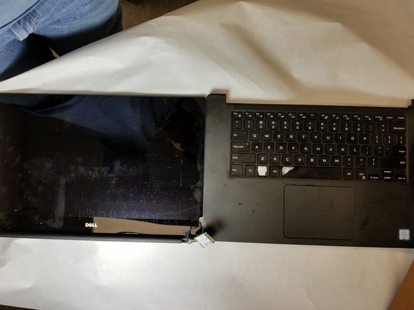

  11. Dell Precision 5510 Screen Replacement: crwdns2935265:011crwdnd2935265:01crwdnd2935265:02crwdne2935265:0 Dell Precision 5510 Screen Replacement: crwdns2935265:011crwdnd2935265:02crwdnd2935265:02crwdne2935265:0
    • Flip the laptop over, so it is sitting in the normal upright position. Hold onto the screen, and pull the keyboard up and away from the screen.
