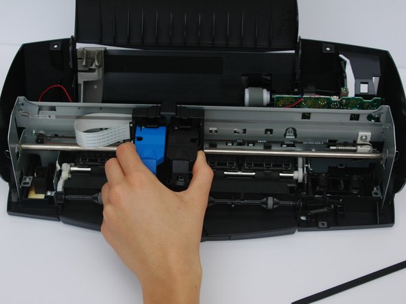

      • Use a Phillips head #2 screwdriver to remove the 4 screws located on the bottom of the Dell Photo Printer 720.
    2. Dell Photo Printer 720 Encoder Strip Replacement: crwdns2935265:02crwdnd2935265:01crwdnd2935265:03crwdne2935265:0 Dell Photo Printer 720 Encoder Strip Replacement: crwdns2935265:02crwdnd2935265:02crwdnd2935265:03crwdne2935265:0 Dell Photo Printer 720 Encoder Strip Replacement: crwdns2935265:02crwdnd2935265:03crwdnd2935265:03crwdne2935265:0
      • Use a spudger to wedge between the cover and base of the printer (where the light grey and black portions meet).
      • Pry apart the light grey cover from the black base.
      • Gently flip the printer upright to its standard position and carefully lift off the cover.

      • Slide the ink cartridge from the right side to the middle left so it is out of the way.

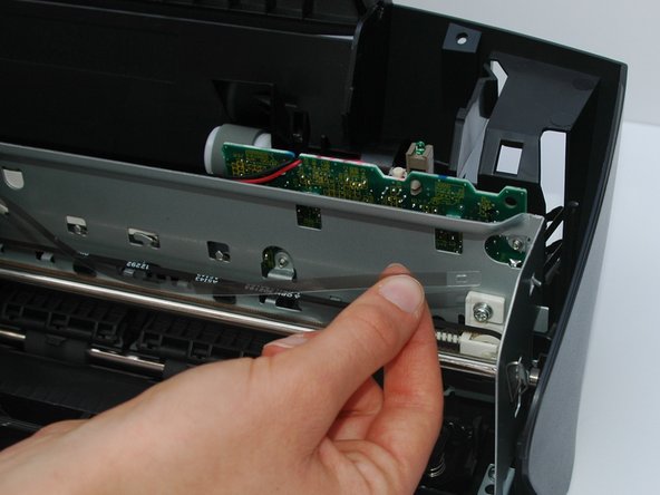

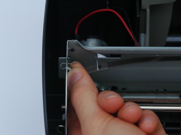

      • Grab ahold of the encoder strip on the right side. Gently tug the strip outward and swing the end piece towards you to unhook the encoder from the prong.
      • Carefully unhook the opposite end of the encoder strip to full disconnect the part.
      • To replace new encoder strip, reattach each end to the hooks by reversing previous steps.
