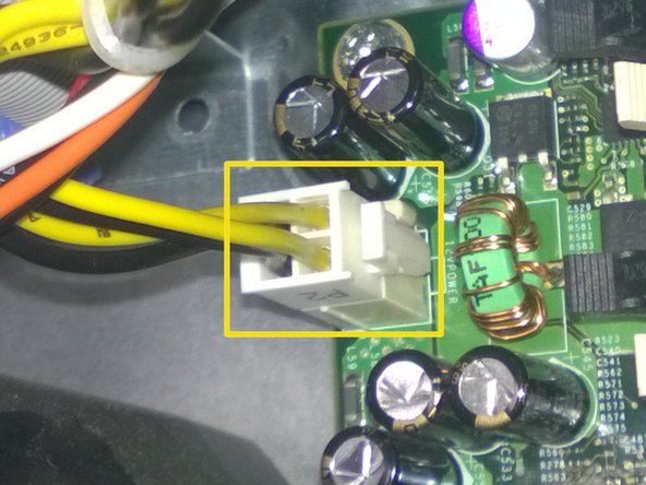

  4. Dell Optiplex GX620 Power Supply Replacement, Disconnect cables: crwdns2935265:04crwdnd2935265:01crwdnd2935265:03crwdne2935265:0 Dell Optiplex GX620 Power Supply Replacement, Disconnect cables: crwdns2935265:04crwdnd2935265:02crwdnd2935265:03crwdne2935265:0 Dell Optiplex GX620 Power Supply Replacement, Disconnect cables: crwdns2935265:04crwdnd2935265:03crwdnd2935265:03crwdne2935265:0
    • Gently disconnect the power cables from the motherboard and drives.
