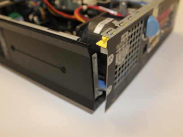

    • Lay the computer on its side; you will see a blue knob.
    • Turn said knob 90 degrees counter clockwise.
  3. Dell Optiplex 745 Ultra Small Form Factor Motherboard Replacement: crwdns2935265:03crwdnd2935265:01crwdnd2935265:01crwdne2935265:0
    • While the knob is still turned, slide the panel case forward about 1/2 inch, and then lift the panel off the computer.

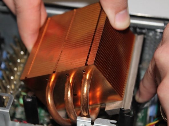

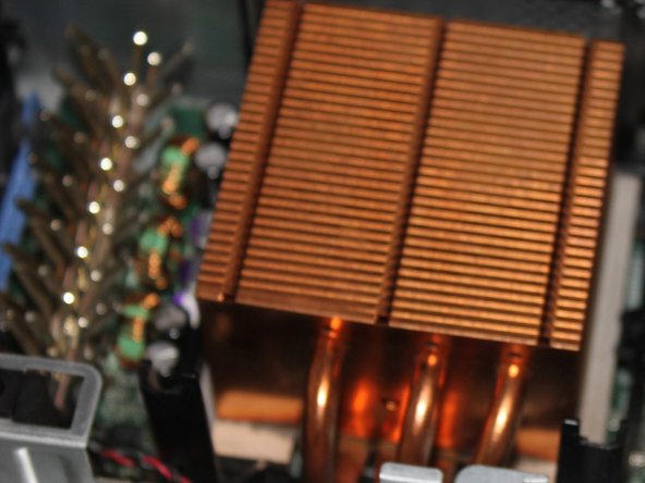

    • Pull back on the tab nearest to the front case fan.
    • Slide the CPU heat sink from under the clip and pull upward.
    • You may need to twist the CPU heat sink side to side to free it from the thermal paste.
