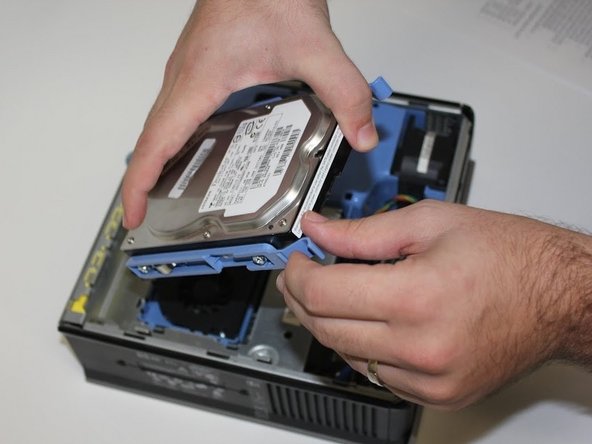

  5. Dell Optiplex 745 Ultra Small Form Factor Hard Drive Replacement: crwdns2935265:05crwdnd2935265:01crwdnd2935265:02crwdne2935265:0 Dell Optiplex 745 Ultra Small Form Factor Hard Drive Replacement: crwdns2935265:05crwdnd2935265:02crwdnd2935265:02crwdne2935265:0
    • Locate the blue tabs shown on the left and right of the hard disk drive
    • Squeeze both tabs and slide the hard disk drive towards you, then lift the drive out of the cage.
