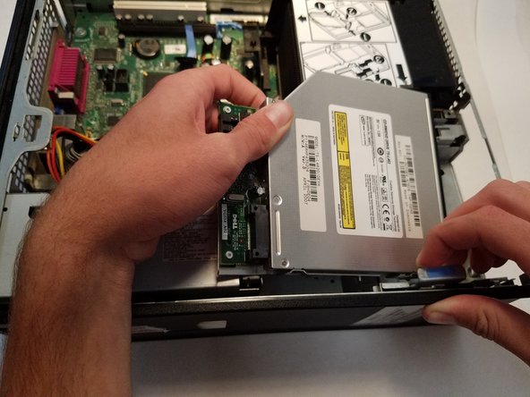

  5. Dell Optiplex 745 Motherboard Replacement: crwdns2935265:05crwdnd2935265:01crwdnd2935265:02crwdne2935265:0 Dell Optiplex 745 Motherboard Replacement: crwdns2935265:05crwdnd2935265:02crwdnd2935265:02crwdne2935265:0
    • Pull the CD drive lock (annotated in blue) straight up.
    • While holding the lock up, pull out the CD drive.

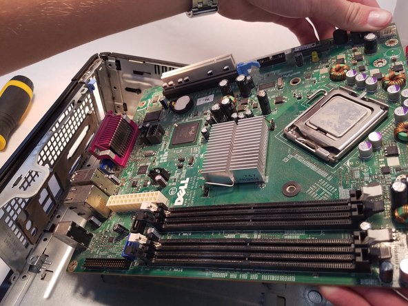

    • Unscrew the two screws holding the Motherboard down (annotated with the red circles).
  14. Dell Optiplex 745 Motherboard Replacement: crwdns2935265:014crwdnd2935265:01crwdnd2935265:02crwdne2935265:0 Dell Optiplex 745 Motherboard Replacement: crwdns2935265:014crwdnd2935265:02crwdnd2935265:02crwdne2935265:0
    • Carefully lift the right side of the Motherboard.
    • After lifting it above the fan, pull it to the right to remove the Motherboard.
  15. Dell Optiplex 745 Motherboard Replacement: crwdns2935265:015crwdnd2935265:01crwdnd2935265:03crwdne2935265:0 Dell Optiplex 745 Motherboard Replacement: crwdns2935265:015crwdnd2935265:02crwdnd2935265:03crwdne2935265:0 Dell Optiplex 745 Motherboard Replacement: crwdns2935265:015crwdnd2935265:03crwdnd2935265:03crwdne2935265:0

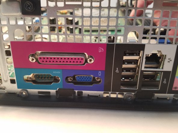

    • Starting with the left side, insert the new Motherboard.
    • Once the ports are lined up, set down the right side of the Motherboard.
    • Then screw it back in and reassemble.
