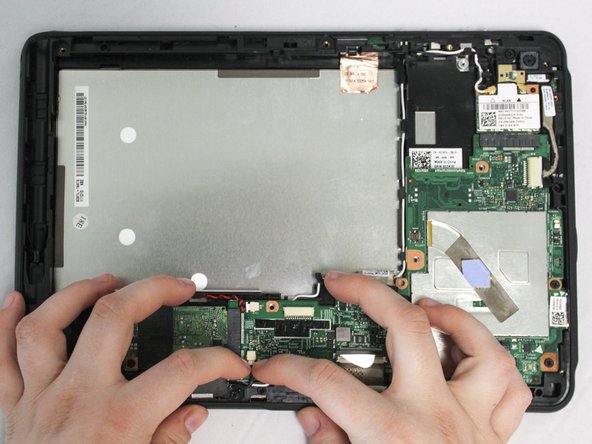

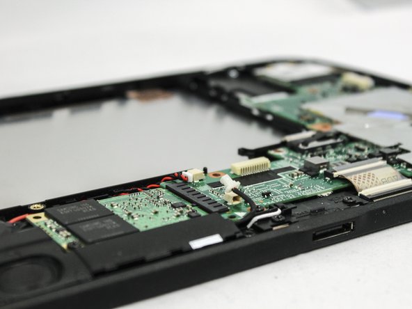

  7. Dell Latitude ST Speaker Replacement, Speaker: crwdns2935265:07crwdnd2935265:01crwdnd2935265:03crwdne2935265:0 Dell Latitude ST Speaker Replacement, Speaker: crwdns2935265:07crwdnd2935265:02crwdnd2935265:03crwdne2935265:0 Dell Latitude ST Speaker Replacement, Speaker: crwdns2935265:07crwdnd2935265:03crwdnd2935265:03crwdne2935265:0
    • Using your hands or a plastic opening tool, disconnect the white speaker connector from its socket near the bottom of the motherboard.

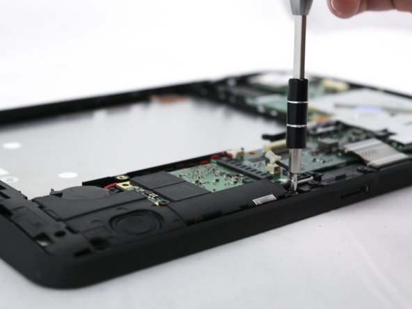

  8. Dell Latitude ST Speaker Replacement: crwdns2935265:08crwdnd2935265:01crwdnd2935265:02crwdne2935265:0 Dell Latitude ST Speaker Replacement: crwdns2935265:08crwdnd2935265:02crwdnd2935265:02crwdne2935265:0
    • Unscrew the 6mm Phillips #0 screw from the left side of the speaker.
    • Unscrew the 3mm Phillips #0 screw from the right side of the speaker.

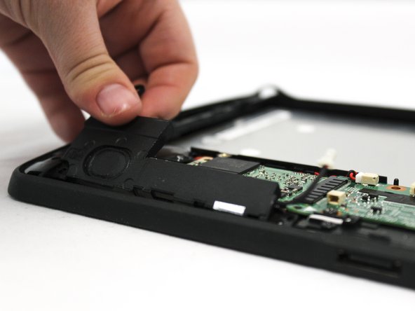

  9. Dell Latitude ST Speaker Replacement: crwdns2935265:09crwdnd2935265:01crwdnd2935265:02crwdne2935265:0 Dell Latitude ST Speaker Replacement: crwdns2935265:09crwdnd2935265:02crwdnd2935265:02crwdne2935265:0
    • Using the plastic opening tool, pry the speaker up to remove it from the device.
