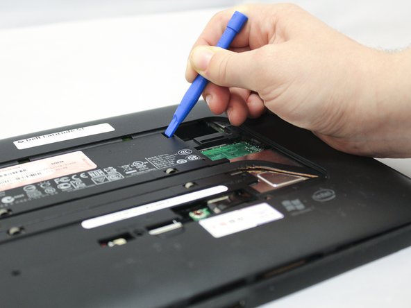

    • Locate the back panel tab.
    • Press down on the tab to remove the panel.
  2. Dell Latitude ST Screen Replacement: crwdns2935265:02crwdnd2935265:01crwdnd2935265:03crwdne2935265:0 Dell Latitude ST Screen Replacement: crwdns2935265:02crwdnd2935265:02crwdnd2935265:03crwdne2935265:0 Dell Latitude ST Screen Replacement: crwdns2935265:02crwdnd2935265:03crwdnd2935265:03crwdne2935265:0
    • Using a Phillips #0 screwdriver, remove the four 6mm screws attaching the inside panel to the device.
  3. Dell Latitude ST Screen Replacement: crwdns2935265:03crwdnd2935265:01crwdnd2935265:03crwdne2935265:0 Dell Latitude ST Screen Replacement: crwdns2935265:03crwdnd2935265:02crwdnd2935265:03crwdne2935265:0 Dell Latitude ST Screen Replacement: crwdns2935265:03crwdnd2935265:03crwdnd2935265:03crwdne2935265:0

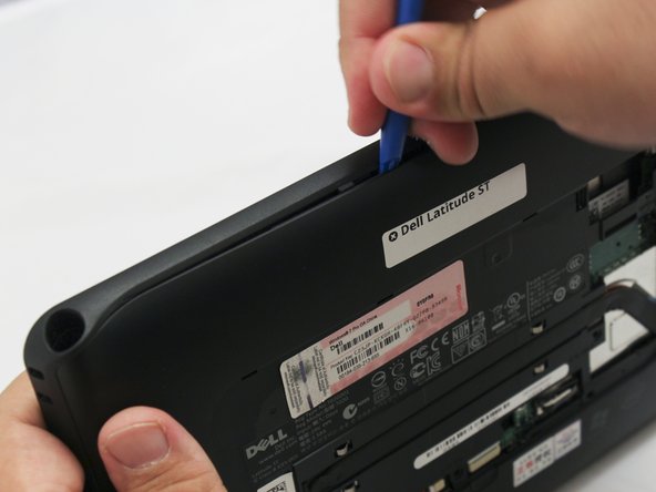

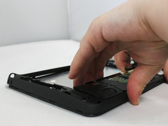

    • Use the blue plastic opening tool to push in the tab located on the backside of the device.
    • Slide the tool around the edges of the device to unsnap the tabs and pry the frame off.

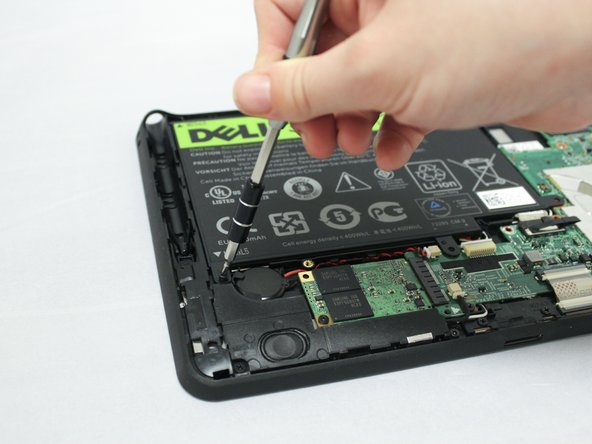

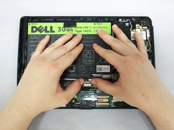

  4. Dell Latitude ST Screen Replacement: crwdns2935265:04crwdnd2935265:01crwdnd2935265:03crwdne2935265:0 Dell Latitude ST Screen Replacement: crwdns2935265:04crwdnd2935265:02crwdnd2935265:03crwdne2935265:0 Dell Latitude ST Screen Replacement: crwdns2935265:04crwdnd2935265:03crwdnd2935265:03crwdne2935265:0
    • Remove the three 6mm Phillips #0 screws attaching the battery.

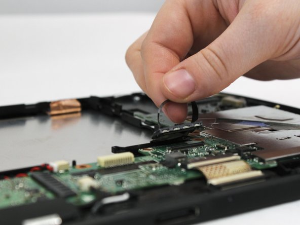

  5. Dell Latitude ST Screen Replacement: crwdns2935265:05crwdnd2935265:01crwdnd2935265:03crwdne2935265:0 Dell Latitude ST Screen Replacement: crwdns2935265:05crwdnd2935265:02crwdnd2935265:03crwdne2935265:0 Dell Latitude ST Screen Replacement: crwdns2935265:05crwdnd2935265:03crwdnd2935265:03crwdne2935265:0
    • Using your hands or a plastic opening tool, unplug the white battery cable.
    • Push forward on the top part of the cable to disconnect it from the device.

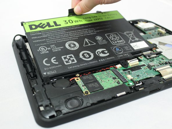

  6. Dell Latitude ST Screen Replacement: crwdns2935265:06crwdnd2935265:01crwdnd2935265:03crwdne2935265:0 Dell Latitude ST Screen Replacement: crwdns2935265:06crwdnd2935265:02crwdnd2935265:03crwdne2935265:0 Dell Latitude ST Screen Replacement: crwdns2935265:06crwdnd2935265:03crwdnd2935265:03crwdne2935265:0
    • Pull up on the black tab located at the top of the battery to remove the battery from the device.

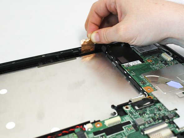

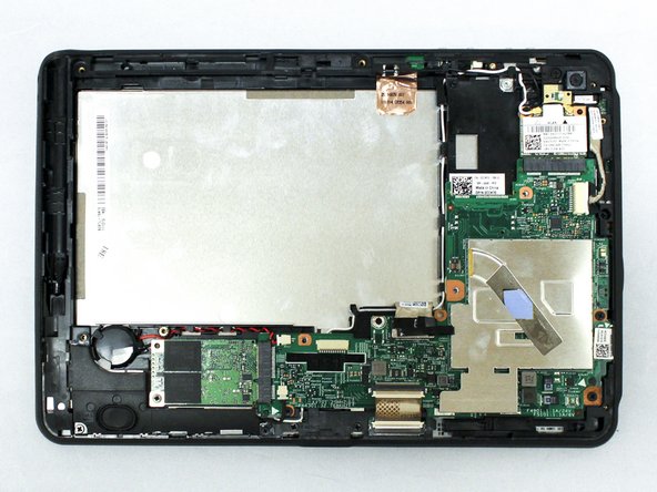

  7. Dell Latitude ST Screen Replacement, Screen: crwdns2935265:07crwdnd2935265:01crwdnd2935265:03crwdne2935265:0 Dell Latitude ST Screen Replacement, Screen: crwdns2935265:07crwdnd2935265:02crwdnd2935265:03crwdne2935265:0 Dell Latitude ST Screen Replacement, Screen: crwdns2935265:07crwdnd2935265:03crwdnd2935265:03crwdne2935265:0
    • Pull up on the copper antenna tape to loosen it from the base.

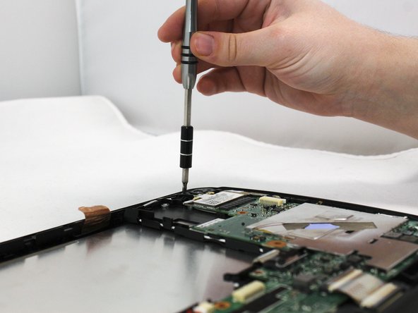

    • Unscrew the seven 6mm Phillips #0 screws from the base.

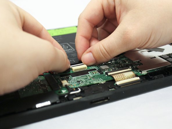

    • Locate the grey LCD cable attached to the motherboad on the device.
    • Pull up on the black tape handle attached to the LCD cable to disconnect the cable.
    • Be sure to pull on the back rather than the LCD cable itself.

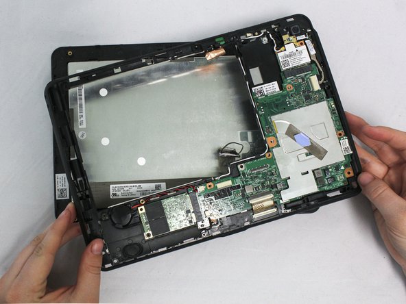

  9. Dell Latitude ST Screen Replacement: crwdns2935265:09crwdnd2935265:01crwdnd2935265:03crwdne2935265:0 Dell Latitude ST Screen Replacement: crwdns2935265:09crwdnd2935265:02crwdnd2935265:03crwdne2935265:0 Dell Latitude ST Screen Replacement: crwdns2935265:09crwdnd2935265:03crwdnd2935265:03crwdne2935265:0
    • Using your hands or the blue plastic opening tool, go along the edges of the frame and unsnap the screen from the middle frame.
    • Lift the middle frame away from the screen.
