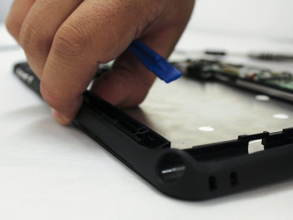

    • Use the blue plastic opening tool to push in the tab located on the backside of the device.
    • Slide the tool around the edges of the device to unsnap the tabs and pry the frame off.

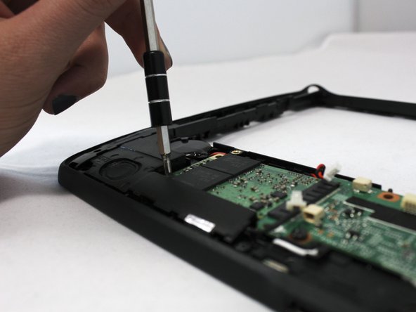

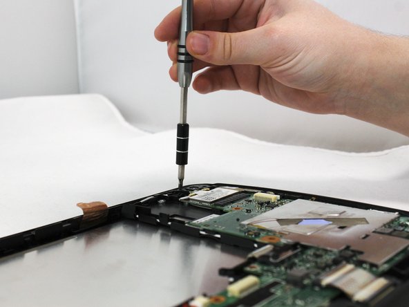

  7. Dell Latitude ST Motherboard Replacement, Motherboard: crwdns2935265:07crwdnd2935265:01crwdnd2935265:02crwdne2935265:0 Dell Latitude ST Motherboard Replacement, Motherboard: crwdns2935265:07crwdnd2935265:02crwdnd2935265:02crwdne2935265:0
    • Remove the 3mm Phillips #0 screw from the SSD drive which is located above the speaker and to the left of the motherboard.

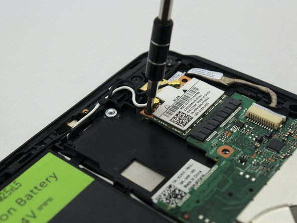

  8. Dell Latitude ST Motherboard Replacement: crwdns2935265:08crwdnd2935265:01crwdnd2935265:03crwdne2935265:0 Dell Latitude ST Motherboard Replacement: crwdns2935265:08crwdnd2935265:02crwdnd2935265:03crwdne2935265:0 Dell Latitude ST Motherboard Replacement: crwdns2935265:08crwdnd2935265:03crwdnd2935265:03crwdne2935265:0

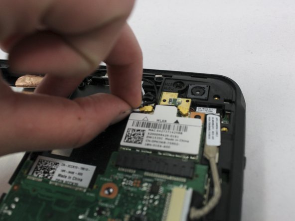

    • Pull up on the white and black cables attached to the WLAN to unplug them.
    • Remove the one 3mm the Phillips #0 screw attached to the WLAN card.
    • Remove the WLAN card.

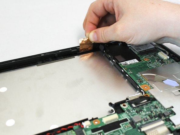

    • Pull up on the copper tape to loosen it from the screen.
    • Unscrew the seven 6mm the Phillips #0 screws from the base.

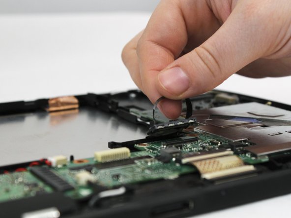

  10. Dell Latitude ST Motherboard Replacement: crwdns2935265:010crwdnd2935265:01crwdnd2935265:02crwdne2935265:0 Dell Latitude ST Motherboard Replacement: crwdns2935265:010crwdnd2935265:02crwdnd2935265:02crwdne2935265:0
    • Locate the grey LCD cable attached to the motherboad on the device.
    • Pull up the black tape handle attached to the LCD cable to disconnect it.

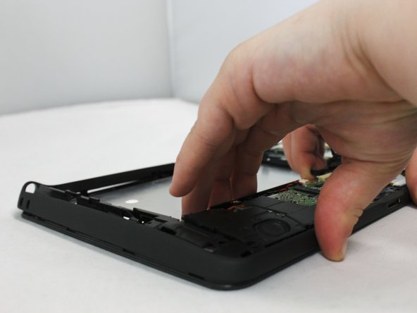

  12. Dell Latitude ST Motherboard Replacement: crwdns2935265:012crwdnd2935265:01crwdnd2935265:03crwdne2935265:0 Dell Latitude ST Motherboard Replacement: crwdns2935265:012crwdnd2935265:02crwdnd2935265:03crwdne2935265:0 Dell Latitude ST Motherboard Replacement: crwdns2935265:012crwdnd2935265:03crwdnd2935265:03crwdne2935265:0

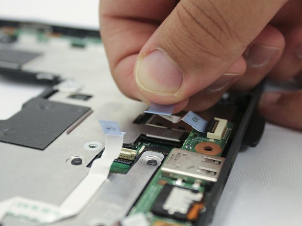

    • Turn over the middle frame.
    • Pull on the white cables with the blue tape to disconnect them.

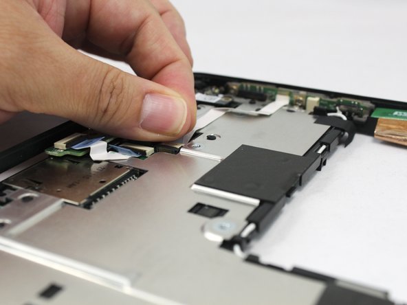

  13. Dell Latitude ST Motherboard Replacement: crwdns2935265:013crwdnd2935265:01crwdnd2935265:02crwdne2935265:0 Dell Latitude ST Motherboard Replacement: crwdns2935265:013crwdnd2935265:02crwdnd2935265:02crwdne2935265:0
    • Flip the middle frame back over.
    • Unplug the three white cables attached to the motherboard.
    • Use the blue plastic opening tool to push down on the cables to disconnect them.

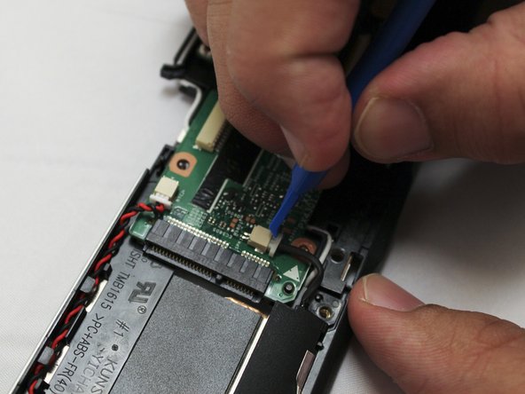

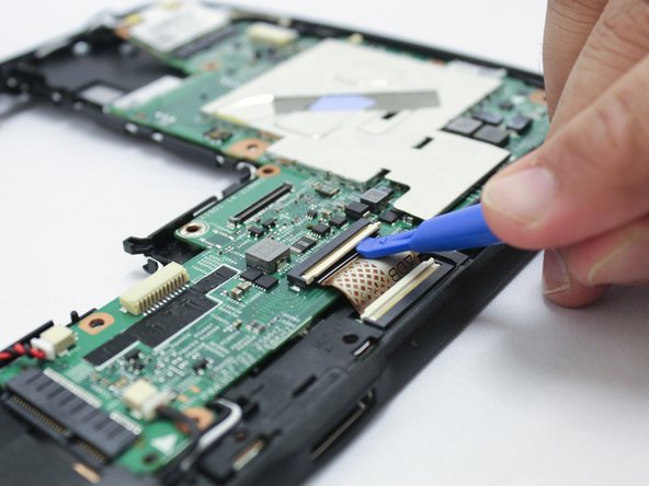

  14. Dell Latitude ST Motherboard Replacement: crwdns2935265:014crwdnd2935265:01crwdnd2935265:03crwdne2935265:0 Dell Latitude ST Motherboard Replacement: crwdns2935265:014crwdnd2935265:02crwdnd2935265:03crwdne2935265:0 Dell Latitude ST Motherboard Replacement: crwdns2935265:014crwdnd2935265:03crwdnd2935265:03crwdne2935265:0

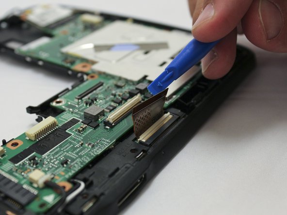

    • Unplug the last motherboard cable attached to the bottom of the frame and the motherboard.
    • With the blue plastic opening tool, flip up the white latch on the top part of the cable.
    • Pull up on the cable using the blue plastic opening tool to disconnect it from the motherboard.

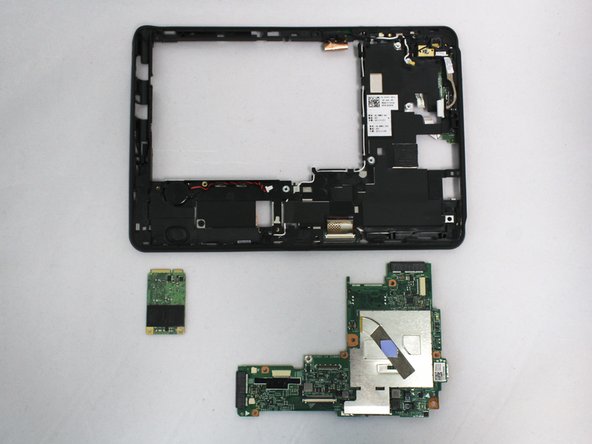

  15. Dell Latitude ST Motherboard Replacement: crwdns2935265:015crwdnd2935265:01crwdnd2935265:03crwdne2935265:0 Dell Latitude ST Motherboard Replacement: crwdns2935265:015crwdnd2935265:02crwdnd2935265:03crwdne2935265:0 Dell Latitude ST Motherboard Replacement: crwdns2935265:015crwdnd2935265:03crwdnd2935265:03crwdne2935265:0

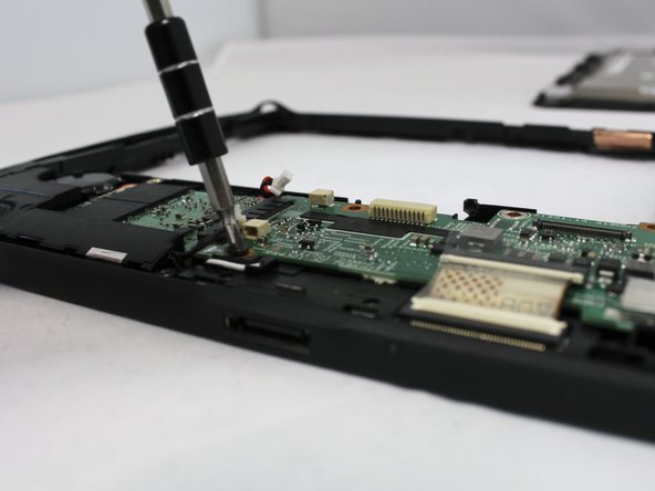

    • Remove the single 6mm screw attaching the motherboard.
    • Remove the Motherboard from the middle frame of the device.
