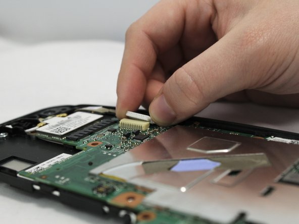

  10. Dell Latitude ST Camera Replacement, Camera: crwdns2935265:010crwdnd2935265:01crwdnd2935265:02crwdne2935265:0 Dell Latitude ST Camera Replacement, Camera: crwdns2935265:010crwdnd2935265:02crwdnd2935265:02crwdne2935265:0
    • Unplug the white camera cord located on the right side of the middle frame under the WLAN card.
    • Using your hands, or the blue plastic opening tool, pull the white part of the cable to the right to disconnect it.

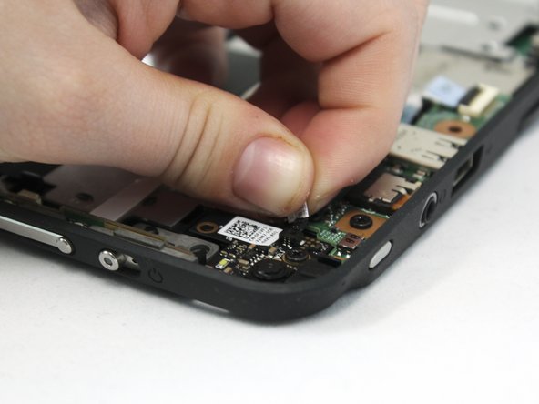

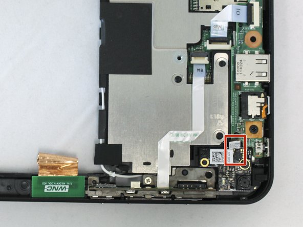

  11. Dell Latitude ST Camera Replacement: crwdns2935265:011crwdnd2935265:01crwdnd2935265:03crwdne2935265:0 Dell Latitude ST Camera Replacement: crwdns2935265:011crwdnd2935265:02crwdnd2935265:03crwdne2935265:0 Dell Latitude ST Camera Replacement: crwdns2935265:011crwdnd2935265:03crwdnd2935265:03crwdne2935265:0
    • Flip over the middle frame.
    • Locate the black and red cables attached to the camera assembly.
    • Gripping them by the white tag, disconnect the black and red cables from their socket on the camera assembly.

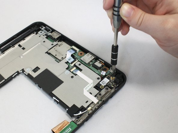

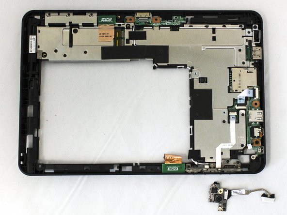

  12. Dell Latitude ST Camera Replacement: crwdns2935265:012crwdnd2935265:01crwdnd2935265:03crwdne2935265:0 Dell Latitude ST Camera Replacement: crwdns2935265:012crwdnd2935265:02crwdnd2935265:03crwdne2935265:0 Dell Latitude ST Camera Replacement: crwdns2935265:012crwdnd2935265:03crwdnd2935265:03crwdne2935265:0
    • Remove the 6mm Phillips #0 screw next to the camera.
    • Pull the camera out to remove it from the device.
