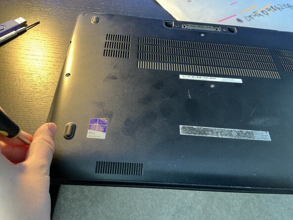

  1. Dell Latitude E7470 Swollen Battery Replacement, Remove screws on back of device: crwdns2935265:01crwdnd2935265:01crwdnd2935265:02crwdne2935265:0 Dell Latitude E7470 Swollen Battery Replacement, Remove screws on back of device: crwdns2935265:01crwdnd2935265:02crwdnd2935265:02crwdne2935265:0
    • It is important to remove these if needed.

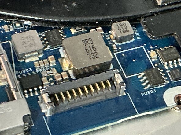

  2. Dell Latitude E7470 Swollen Battery Replacement, Disconnect the cable: crwdns2935265:02crwdnd2935265:01crwdnd2935265:02crwdne2935265:0 Dell Latitude E7470 Swollen Battery Replacement, Disconnect the cable: crwdns2935265:02crwdnd2935265:02crwdnd2935265:02crwdne2935265:0
    • Disconnect the cable to release the battery
    • If you puncture the battery, it can catch fire
    • The laptop is an 8th gen i7 (Coffee Lake, Released 2017). Unsure? Search i7 8th generation

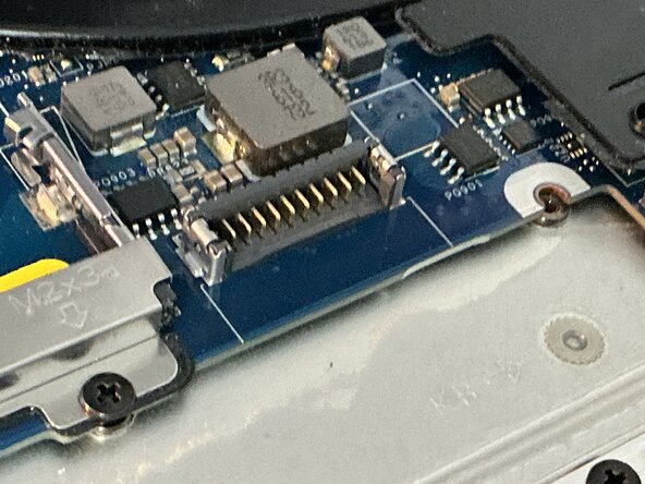

  3. Dell Latitude E7470 Swollen Battery Replacement, Unscrew the battery: crwdns2935265:03crwdnd2935265:01crwdnd2935265:01crwdne2935265:0
    • Unscrew battery with all screws removed from the battery
    • Puncturing a lithium-ion battery can lead to several risks, including fire or explosion, toxic leaks, and injury. Sharp edges and high temperatures can cause severe injuries. Therefore, it’s important to handle batteries with care and contact a professional disposal service immediately if they are damaged.
    • Unbox the battery by peeling the tabs as you see in the box. Next, lift it up and take it out of its wrap
    • You shouldn’t puncture a li-ion battery, which is dangerous
    • This battery doesn’t swell, so be happy
    • This battery cannot be removed from its socket
  4. Dell Latitude E7470 Swollen Battery Replacement, Inserting the new battery: crwdns2935265:05crwdnd2935265:01crwdnd2935265:02crwdne2935265:0 Dell Latitude E7470 Swollen Battery Replacement, Inserting the new battery: crwdns2935265:05crwdnd2935265:02crwdnd2935265:02crwdne2935265:0
    • Screw the screws after you place the battery inside.
    • Carefully place it inside the battery area.
