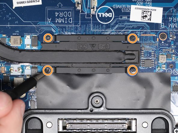

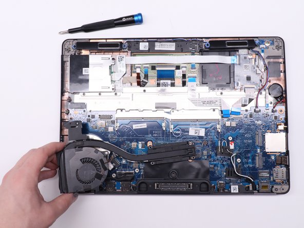

    • Unplug the fan's power connector.
    • Remove the four 2 mm screws holding in the heat sink using a Phillips #0 screwdriver.
    • Carefully lift the entire laptop cooling assembly straight up from the motherboard.

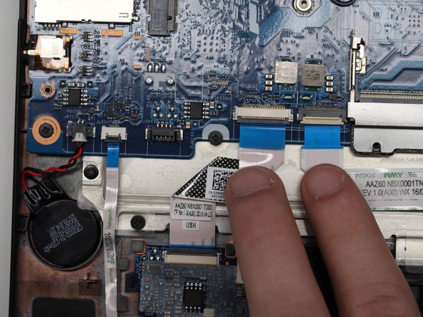

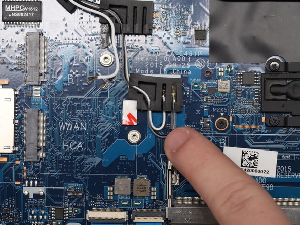

    • Remove the antenna wires from the rubber housing.
    • Remove all wire connections on the motherboard.
    • The 'flat' wires have a different connector which will require you to flip a tab up that anchors the wire. Then you can pull the wire straight out parallel to the motherboard.

  17. Dell Latitude E7470 Motherboard Replacement: crwdns2935265:017crwdnd2935265:01crwdnd2935265:02crwdne2935265:0 Dell Latitude E7470 Motherboard Replacement: crwdns2935265:017crwdnd2935265:02crwdnd2935265:02crwdne2935265:0
    • Carefully lift the motherboard straight up from the laptop.
    • If you feel any resistance, check that there are not any screws or connections that you may have missed.
