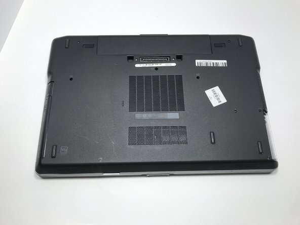

    • Flip the computer over so that the bottom panel is facing you.
