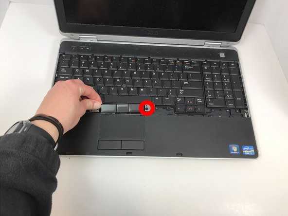

    • Use the spludger to lift the grey casing off the Dell Latitude E6530 keyboard.
  3. Dell Latitude E6530  Motherboard Replacement: crwdns2935265:03crwdnd2935265:01crwdnd2935265:02crwdne2935265:0 Dell Latitude E6530  Motherboard Replacement: crwdns2935265:03crwdnd2935265:02crwdnd2935265:02crwdne2935265:0
    • Using a Phillips #1 Screwdriver, unscrew the button panel.
    • Life the button panel out of the Dell Latitude E6530.
