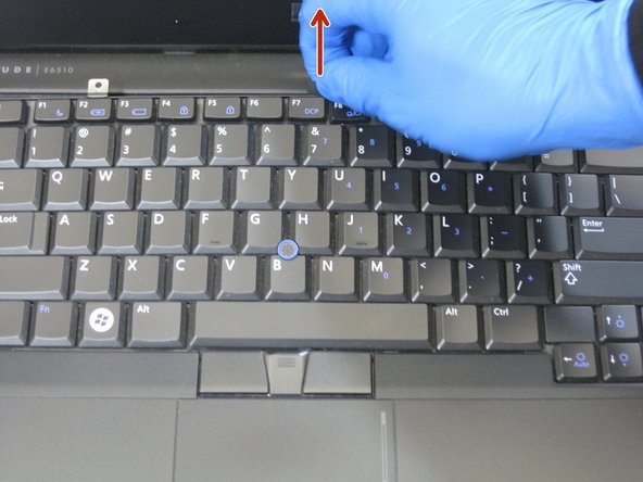

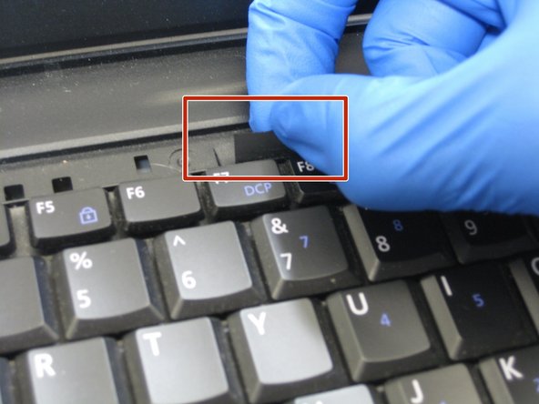

    • Open the laptop and locate the volume panel on the keyboard.
    • Use the spudger to get underneath the righthand side of the panel and gently pry up the side.

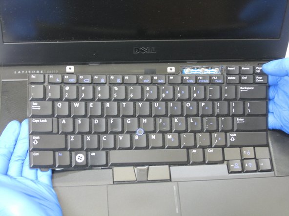

  3. Dell Latitude E6510 Speaker Replacement: crwdns2935265:03crwdnd2935265:01crwdnd2935265:03crwdne2935265:0 Dell Latitude E6510 Speaker Replacement: crwdns2935265:03crwdnd2935265:02crwdnd2935265:03crwdne2935265:0 Dell Latitude E6510 Speaker Replacement: crwdns2935265:03crwdnd2935265:03crwdnd2935265:03crwdne2935265:0
    • Locate the tab near the back of the keyboard.
    • Pull upwards on the tab to start removing the keyboard and then using both hands at the sides, pull until the keyboard comes free.

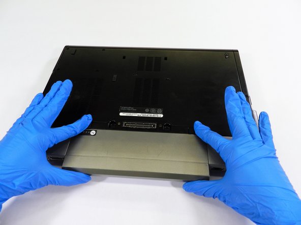

    Dell Latitude E6510 Speaker Replacement, Battery: crwdns2935265:04crwdnd2935265:01crwdnd2935265:01crwdne2935265:0

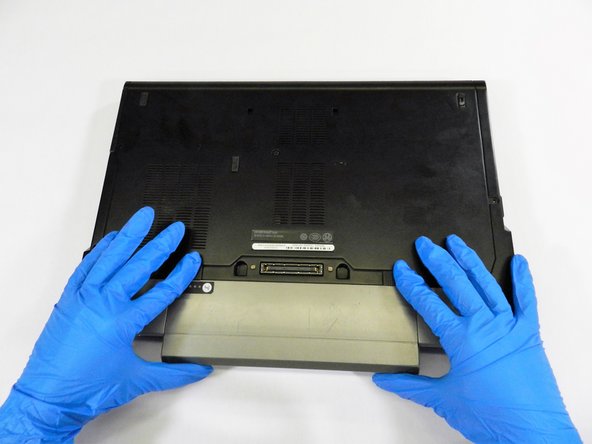

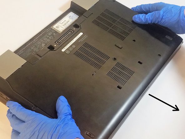

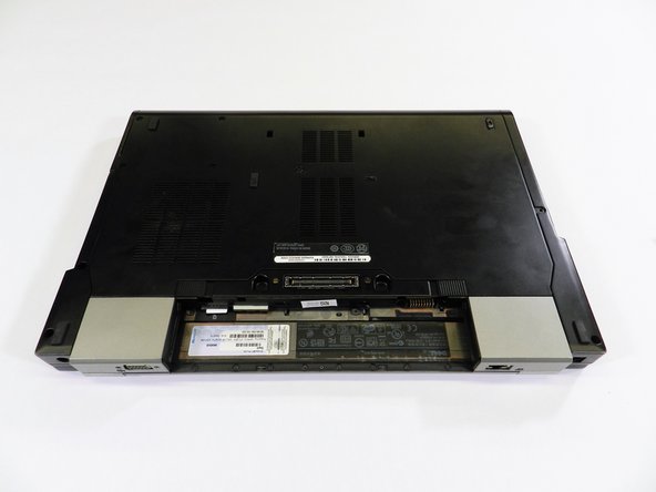

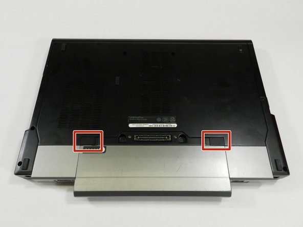

    • Make sure the device is shutdown
    • Position the laptop upside down with the battery facing towards you.
    • Locate the battery latches circled in red.

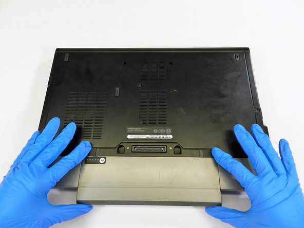

  5. Dell Latitude E6510 Speaker Replacement: crwdns2935265:05crwdnd2935265:01crwdnd2935265:02crwdne2935265:0 Dell Latitude E6510 Speaker Replacement: crwdns2935265:05crwdnd2935265:02crwdnd2935265:02crwdne2935265:0
    • Gently slide both latches inward until you hear both latches release.

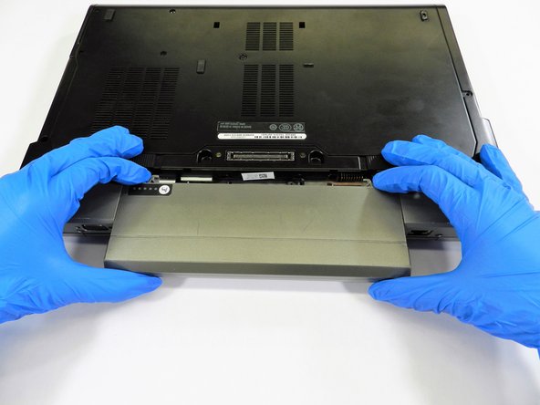

  6. Dell Latitude E6510 Speaker Replacement: crwdns2935265:06crwdnd2935265:01crwdnd2935265:03crwdne2935265:0 Dell Latitude E6510 Speaker Replacement: crwdns2935265:06crwdnd2935265:02crwdnd2935265:03crwdne2935265:0 Dell Latitude E6510 Speaker Replacement: crwdns2935265:06crwdnd2935265:03crwdnd2935265:03crwdne2935265:0
    • Pull the battery towards yourself as shown until completely removed from the computer.

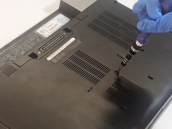

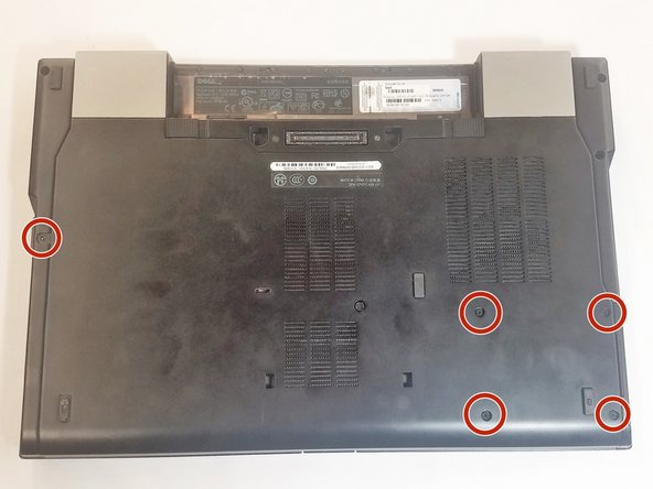

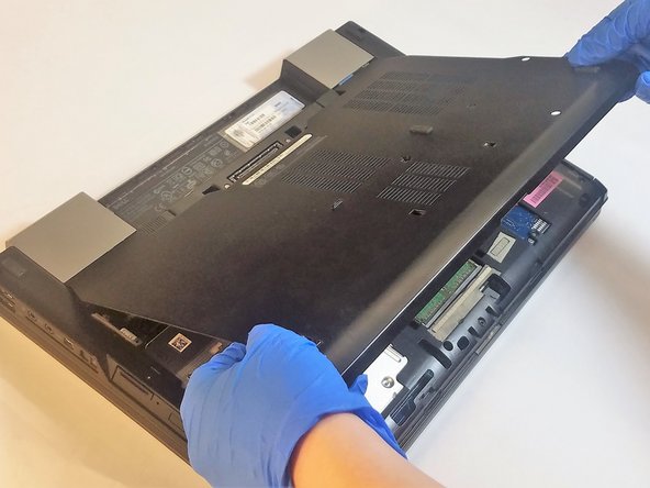

    • Flip over laptop and locate door panel screws.
    • Remove the Screws.
  8. Dell Latitude E6510 Speaker Replacement: crwdns2935265:08crwdnd2935265:01crwdnd2935265:02crwdne2935265:0 Dell Latitude E6510 Speaker Replacement: crwdns2935265:08crwdnd2935265:02crwdnd2935265:02crwdne2935265:0
    • Slide and remove the access door.

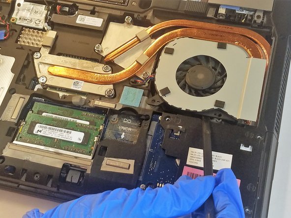

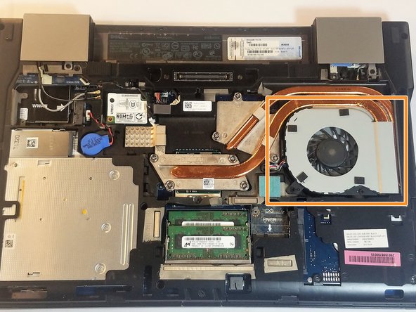

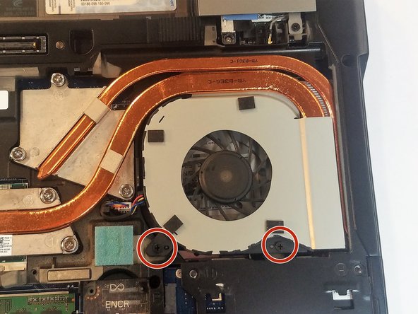

    • Locate the fan and two fan screws.
    • Remove the 2 screws using a PZ0 Phillip head screwdriver.

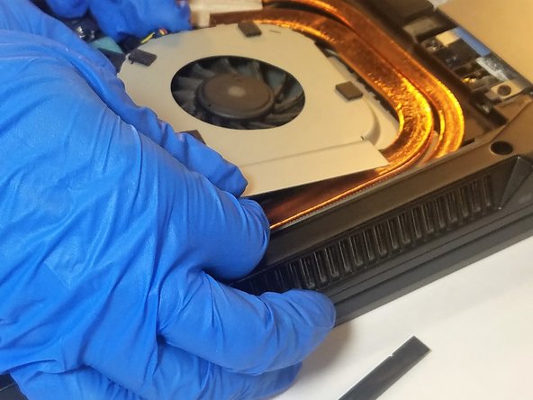

  10. Dell Latitude E6510 Speaker Replacement: crwdns2935265:010crwdnd2935265:01crwdnd2935265:02crwdne2935265:0 Dell Latitude E6510 Speaker Replacement: crwdns2935265:010crwdnd2935265:02crwdnd2935265:02crwdne2935265:0
    • Using a plastic spudger, gently pry the fan upwards.
    • Once the fan has been loosened, slowly remove the main fan component.
    • Do not pull too hard as their is still a wire attached.

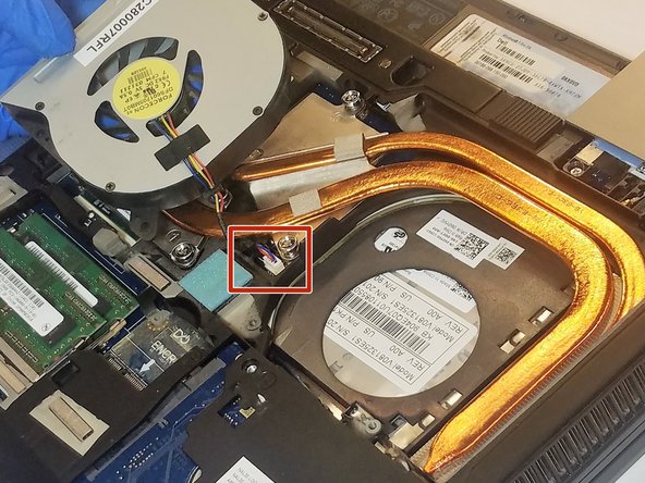

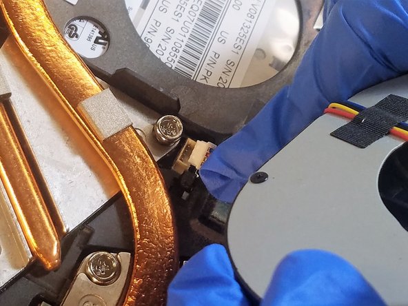

  11. Dell Latitude E6510 Speaker Replacement: crwdns2935265:011crwdnd2935265:01crwdnd2935265:02crwdne2935265:0 Dell Latitude E6510 Speaker Replacement: crwdns2935265:011crwdnd2935265:02crwdnd2935265:02crwdne2935265:0
    • Locate the wire holding the fan in place and detach the clip.
