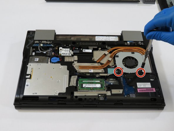

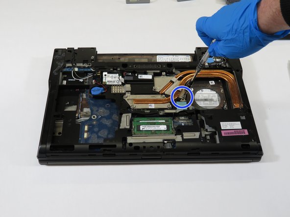

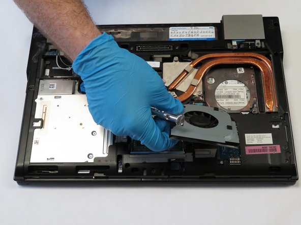

  7. Dell Latitude E6510  USB Ports Replacement: crwdns2935265:07crwdnd2935265:01crwdnd2935265:03crwdne2935265:0 Dell Latitude E6510  USB Ports Replacement: crwdns2935265:07crwdnd2935265:02crwdnd2935265:03crwdne2935265:0 Dell Latitude E6510  USB Ports Replacement: crwdns2935265:07crwdnd2935265:03crwdnd2935265:03crwdne2935265:0
    • Using the Philips head screwdriver unscrew the two screws holding the fan.
    • Next, slide the fan out from under the copper heat sink.
    • Unplug the connector marked in blue and remove the fan.
