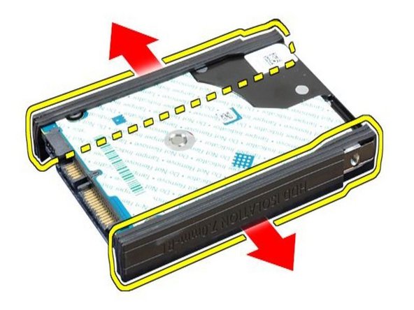

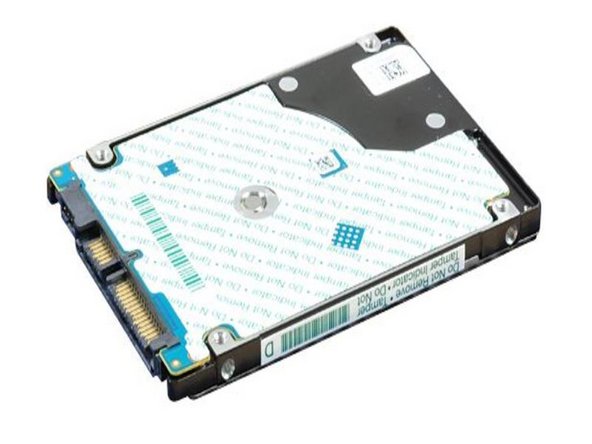

  4. Dell Latitude E6440 Hard Drive Replacement, Remove Hard Drive Caddy: crwdns2935265:05crwdnd2935265:01crwdnd2935265:03crwdne2935265:0 Dell Latitude E6440 Hard Drive Replacement, Remove Hard Drive Caddy: crwdns2935265:05crwdnd2935265:02crwdnd2935265:03crwdne2935265:0 Dell Latitude E6440 Hard Drive Replacement, Remove Hard Drive Caddy: crwdns2935265:05crwdnd2935265:03crwdnd2935265:03crwdne2935265:0
    • Remove the single screw holding the hard drive door in place. Next, separate the right edge of the hard drive door and remove the hard drive door. Then, peel off and remove the hard drive isolations on both sides.
    • With your new hard drive, complete the previous steps in reverse order and reinsert the battery.
