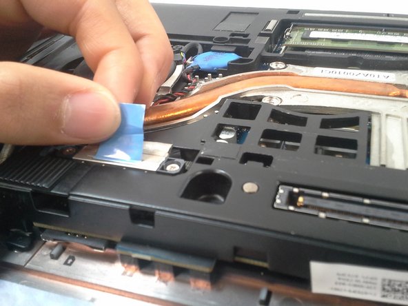

    • Loosen the two 5mm Phillip's screws near the top right corner that are holding the display cable onto the motherboard.
  6. Dell Latitude E6410 Screen Assembly Replacement: crwdns2935265:06crwdnd2935265:01crwdnd2935265:03crwdne2935265:0 Dell Latitude E6410 Screen Assembly Replacement: crwdns2935265:06crwdnd2935265:02crwdnd2935265:03crwdne2935265:0 Dell Latitude E6410 Screen Assembly Replacement: crwdns2935265:06crwdnd2935265:03crwdnd2935265:03crwdne2935265:0
    • Detach the display cord from the motherboard by grabbing the blue tab in between your thumb and index finger and carefully pulling upwards.
    • Don't pull too hard or you may rip off the tab, but apply enough pressure so that it actually comes off.

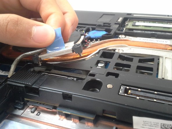

  7. Dell Latitude E6410 Screen Assembly Replacement: crwdns2935265:07crwdnd2935265:01crwdnd2935265:03crwdne2935265:0 Dell Latitude E6410 Screen Assembly Replacement: crwdns2935265:07crwdnd2935265:02crwdnd2935265:03crwdne2935265:0 Dell Latitude E6410 Screen Assembly Replacement: crwdns2935265:07crwdnd2935265:03crwdnd2935265:03crwdne2935265:0
    • Near the bottom left corner, detach the grey, black, and white wires from the graphics card and the two wires hooked in place by carefully unhooking them or pulling them off.
    • When reassembling use the second or last picture to reference where each wire goes.
  8. Dell Latitude E6410 Screen Assembly Replacement: crwdns2935265:08crwdnd2935265:01crwdnd2935265:01crwdne2935265:0
    • Carefully unthread the wires detached in the last step from the hooks to completely free them from the laptop.
