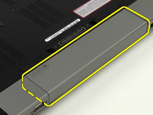

  2. Dell Latitude E6410 CMOS Battery Replacement, Remove battery: crwdns2935265:02crwdnd2935265:01crwdnd2935265:03crwdne2935265:0 Dell Latitude E6410 CMOS Battery Replacement, Remove battery: crwdns2935265:02crwdnd2935265:02crwdnd2935265:03crwdne2935265:0 Dell Latitude E6410 CMOS Battery Replacement, Remove battery: crwdns2935265:02crwdnd2935265:03crwdnd2935265:03crwdne2935265:0
    • To remove the battery, slide the latches inward, and remove the battery from the system.

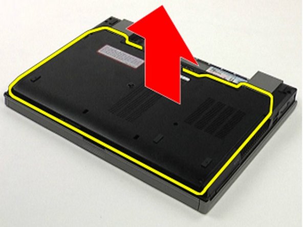

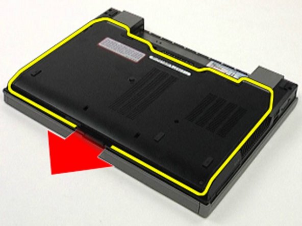

  3. Dell Latitude E6410 CMOS Battery Replacement, Remove the access panel: crwdns2935265:03crwdnd2935265:01crwdnd2935265:03crwdne2935265:0 Dell Latitude E6410 CMOS Battery Replacement, Remove the access panel: crwdns2935265:03crwdnd2935265:02crwdnd2935265:03crwdne2935265:0 Dell Latitude E6410 CMOS Battery Replacement, Remove the access panel: crwdns2935265:03crwdnd2935265:03crwdnd2935265:03crwdne2935265:0
    • To remove the access panel, use your screwdriver to remove the single screw in the center of the base. Then, slide the access panel toward the front of the system and lift it from the system.

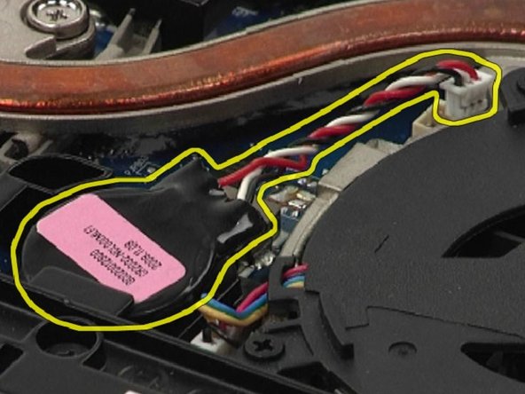

  4. Dell Latitude E6410 CMOS Battery Replacement, Disconnect the coin-cell battery cable from the system board: crwdns2935265:04crwdnd2935265:01crwdnd2935265:03crwdne2935265:0 Dell Latitude E6410 CMOS Battery Replacement, Disconnect the coin-cell battery cable from the system board: crwdns2935265:04crwdnd2935265:02crwdnd2935265:03crwdne2935265:0 Dell Latitude E6410 CMOS Battery Replacement, Disconnect the coin-cell battery cable from the system board: crwdns2935265:04crwdnd2935265:03crwdnd2935265:03crwdne2935265:0
    • After removing the access panel, locate the coin cell battery. Then disconnect the battery cable from the system board and lift the coin-cell battery out of its socket to remove.
