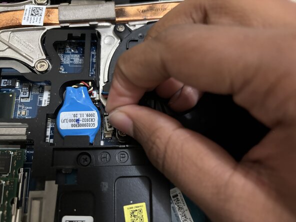

  2. Dell Latitude E6400 Heatsink and Thermal Paste Replacement, Removing/Cleaning Fan: crwdns2935265:02crwdnd2935265:01crwdnd2935265:03crwdne2935265:0 Dell Latitude E6400 Heatsink and Thermal Paste Replacement, Removing/Cleaning Fan: crwdns2935265:02crwdnd2935265:02crwdnd2935265:03crwdne2935265:0 Dell Latitude E6400 Heatsink and Thermal Paste Replacement, Removing/Cleaning Fan: crwdns2935265:02crwdnd2935265:03crwdnd2935265:03crwdne2935265:0
    • Disconnect the fan cable by gently pulling up on the plastic connector.
    • Unscrew the 2 silver screws holding the fan in place.
    • Remove the piece of black tape sealing the fan to the exhaust vent. Pull up on the left side of the fan next to the CMOS coin battery to remove the fan
    • Use a toothbrush or small soft paintbrush and an air duster or canned air to remove dust from the exhaust vent, and the fan blades, which need to be held in place with a finger or toothpick. (optional)
