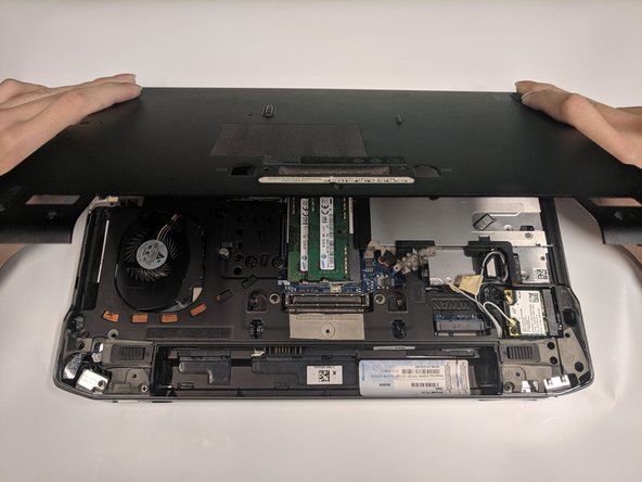

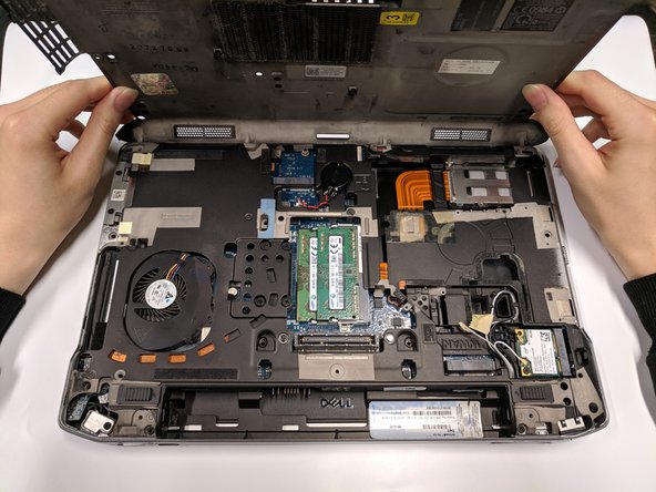

  3. Dell Latitude E6330 Speakers Replacement, Removing the Backplate: crwdns2935265:03crwdnd2935265:01crwdnd2935265:03crwdne2935265:0 Dell Latitude E6330 Speakers Replacement, Removing the Backplate: crwdns2935265:03crwdnd2935265:02crwdnd2935265:03crwdne2935265:0 Dell Latitude E6330 Speakers Replacement, Removing the Backplate: crwdns2935265:03crwdnd2935265:03crwdnd2935265:03crwdne2935265:0
    • Unscrew the five screws (Phillips Head 1 2.5mm x 5mm).
    • Remove the backplate by pulling from the battery to the front.
