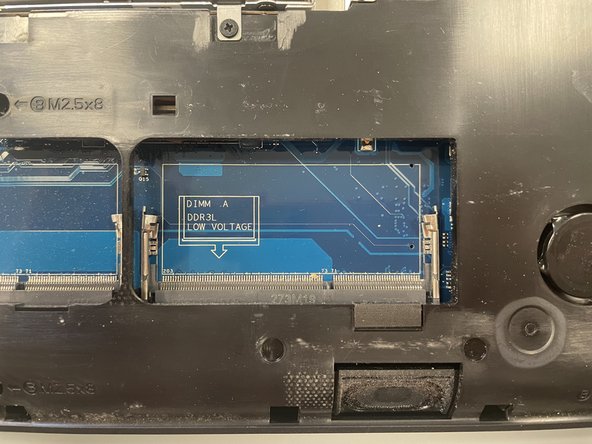

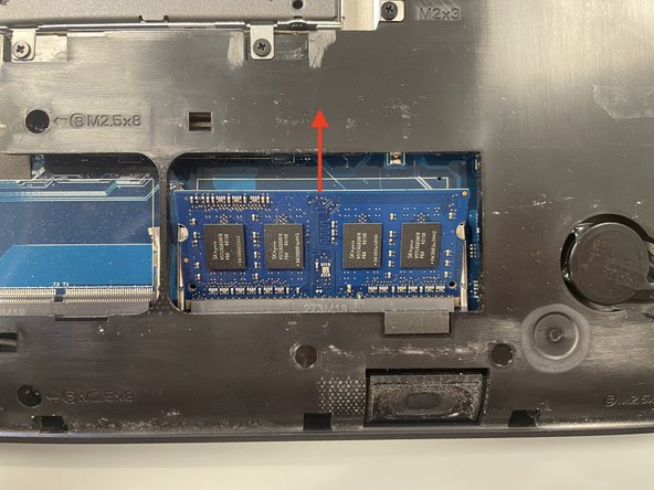

  3. Dell Latitude E5540 Disassembly, Removing the RAM: crwdns2935265:03crwdnd2935265:01crwdnd2935265:03crwdne2935265:0 Dell Latitude E5540 Disassembly, Removing the RAM: crwdns2935265:03crwdnd2935265:02crwdnd2935265:03crwdne2935265:0 Dell Latitude E5540 Disassembly, Removing the RAM: crwdns2935265:03crwdnd2935265:03crwdnd2935265:03crwdne2935265:0
    • Remove the RAM by pushing the metal parts slightly outward
    • The RAM will pop up and you can carefully slide it out

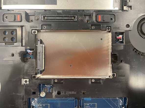

  4. Dell Latitude E5540 Disassembly, Removing the Hard Drive: crwdns2935265:04crwdnd2935265:01crwdnd2935265:03crwdne2935265:0 Dell Latitude E5540 Disassembly, Removing the Hard Drive: crwdns2935265:04crwdnd2935265:02crwdnd2935265:03crwdne2935265:0 Dell Latitude E5540 Disassembly, Removing the Hard Drive: crwdns2935265:04crwdnd2935265:03crwdnd2935265:03crwdne2935265:0
    • Remove the four M2x3 screws with a Phillips PH0 screwdriver
    • Slide the hard drive cradle out by pulling the plastic tab

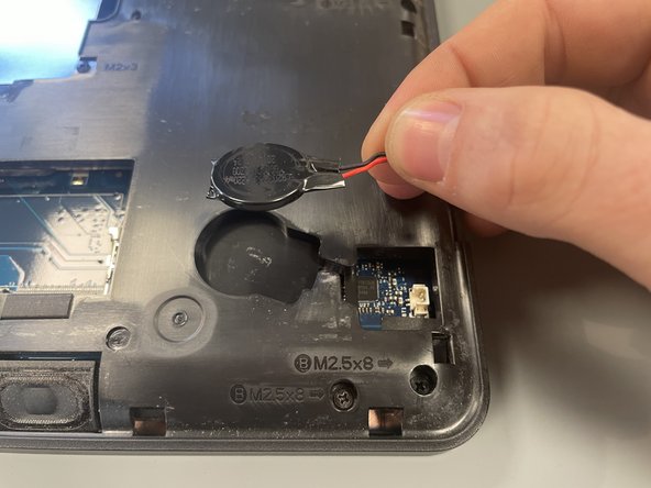

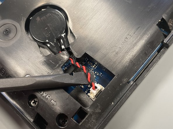

  6. Dell Latitude E5540 Disassembly, Remove the CMOS Battery: crwdns2935265:06crwdnd2935265:01crwdnd2935265:03crwdne2935265:0 Dell Latitude E5540 Disassembly, Remove the CMOS Battery: crwdns2935265:06crwdnd2935265:02crwdnd2935265:03crwdne2935265:0 Dell Latitude E5540 Disassembly, Remove the CMOS Battery: crwdns2935265:06crwdnd2935265:03crwdnd2935265:03crwdne2935265:0
    • Use a blackstick to carefully disconnect the battery connector
    • Gently guide the cable through the narrowed part and remove the battery that is held in place with double sided tape

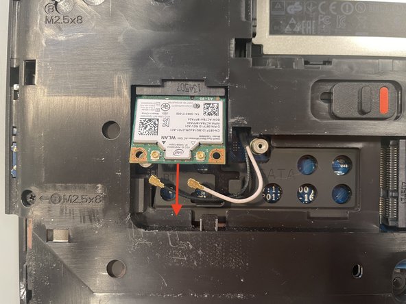

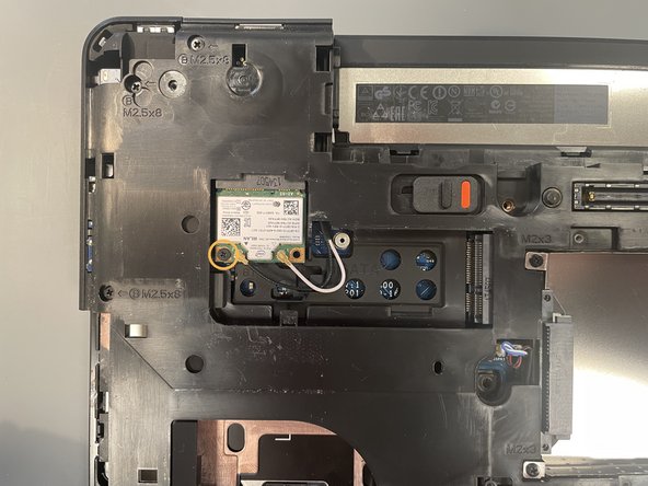

  7. Dell Latitude E5540 Disassembly, Disconnect and Remove the Bluetooth and Wifi Module: crwdns2935265:07crwdnd2935265:01crwdnd2935265:03crwdne2935265:0 Dell Latitude E5540 Disassembly, Disconnect and Remove the Bluetooth and Wifi Module: crwdns2935265:07crwdnd2935265:02crwdnd2935265:03crwdne2935265:0 Dell Latitude E5540 Disassembly, Disconnect and Remove the Bluetooth and Wifi Module: crwdns2935265:07crwdnd2935265:03crwdnd2935265:03crwdne2935265:0
    • Gently disconnect the white and black cable from the module with a blackstick
    • Remove one M2x3 screw with a Phillips PH0 screwdriver. The module will push up
    • Remove the module by sliding it out

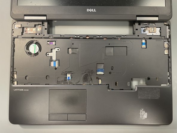

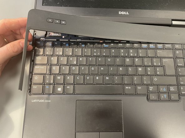

  8. Dell Latitude E5540 Disassembly, Remove the Top Panel: crwdns2935265:08crwdnd2935265:01crwdnd2935265:03crwdne2935265:0 Dell Latitude E5540 Disassembly, Remove the Top Panel: crwdns2935265:08crwdnd2935265:02crwdnd2935265:03crwdne2935265:0 Dell Latitude E5540 Disassembly, Remove the Top Panel: crwdns2935265:08crwdnd2935265:03crwdnd2935265:03crwdne2935265:0
    • Turn the laptop over and open the screen, carefully place the spudger under the top panel near the bottom left Ctrl key and push up
    • Gently remove the rest of the panel

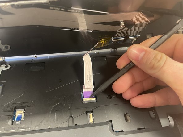

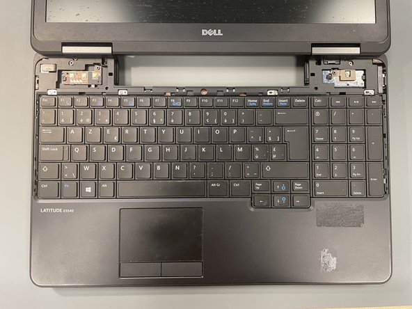

  9. Dell Latitude E5540 Disassembly, Remove the Keyboard: crwdns2935265:09crwdnd2935265:01crwdnd2935265:03crwdne2935265:0 Dell Latitude E5540 Disassembly, Remove the Keyboard: crwdns2935265:09crwdnd2935265:02crwdnd2935265:03crwdne2935265:0 Dell Latitude E5540 Disassembly, Remove the Keyboard: crwdns2935265:09crwdnd2935265:03crwdnd2935265:03crwdne2935265:0
    • Remove four silver screws with a Phillips PH0 screwdriver, slide the keyboard up a couple of millimetres then lift it up away from you to expose the ribbon cable
    • Disconnect the ribbon cable with the help of a spudger and remove the keyboard
