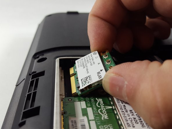

    • Unscrew the single 3.5mm Phillips #1 screw that holds on the bottom plate of the device.
  2. Dell Latitude E5500 Wireless Card Replacement: crwdns2935265:02crwdnd2935265:01crwdnd2935265:02crwdne2935265:0 Dell Latitude E5500 Wireless Card Replacement: crwdns2935265:02crwdnd2935265:02crwdnd2935265:02crwdne2935265:0
    • Place your hands on the plate and pull it toward yourself.
    • The plate will pop out of place and may then be removed.
  3. Dell Latitude E5500 Wireless Card Replacement: crwdns2935265:03crwdnd2935265:01crwdnd2935265:02crwdne2935265:0 Dell Latitude E5500 Wireless Card Replacement: crwdns2935265:03crwdnd2935265:02crwdnd2935265:02crwdne2935265:0
    • The wireless card is located near the front of the device, and is the expansion card with three antennas attached to it.
  4. Dell Latitude E5500 Wireless Card Replacement: crwdns2935265:04crwdnd2935265:01crwdnd2935265:01crwdne2935265:0
    • Remove the wires connecting the card to the laptop with a pair of tweezers.
  5. Dell Latitude E5500 Wireless Card Replacement: crwdns2935265:05crwdnd2935265:01crwdnd2935265:01crwdne2935265:0
    • Unscrew the 4mm Phillips #1 screw that secure the card in place.
  6. Dell Latitude E5500 Wireless Card Replacement: crwdns2935265:06crwdnd2935265:01crwdnd2935265:02crwdne2935265:0 Dell Latitude E5500 Wireless Card Replacement: crwdns2935265:06crwdnd2935265:02crwdnd2935265:02crwdne2935265:0
    • After completing steps 4 & 5, the card will lift up at an angle as shown.
    • Once the card has popped out of place, it can be gently removed.
