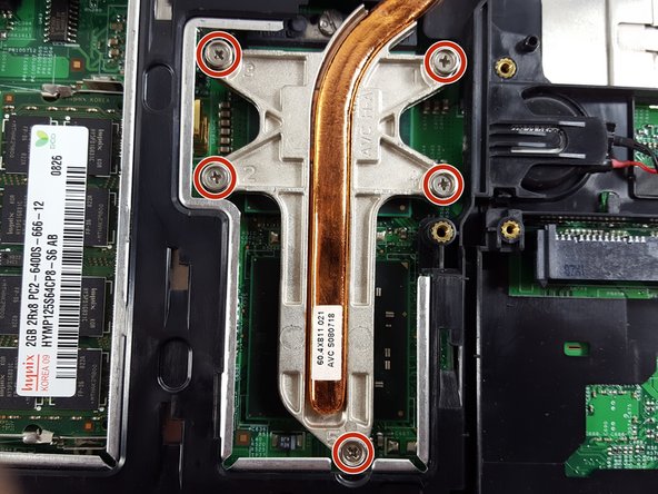

    • The system's heatsink is the copper pipe and large metal assembly held down by five screws.
    • Remove the five Phillips #1 screws in the order numbered on the metal assembly.

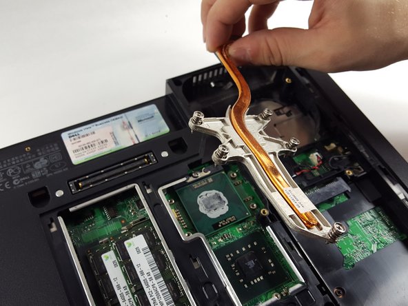

  7. Dell Latitude E5500 Thermal Compound Replacement: crwdns2935265:07crwdnd2935265:01crwdnd2935265:03crwdne2935265:0 Dell Latitude E5500 Thermal Compound Replacement: crwdns2935265:07crwdnd2935265:02crwdnd2935265:03crwdne2935265:0 Dell Latitude E5500 Thermal Compound Replacement: crwdns2935265:07crwdnd2935265:03crwdnd2935265:03crwdne2935265:0
    • The screws are self-retaining, meaning they will stay connected to the heatsink and will not fall out from the assembly.
    • After all screws have been unscrewed, the heatsink can be removed.

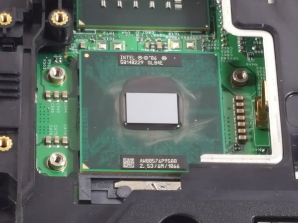

  10. Dell Latitude E5500 Thermal Compound Replacement: crwdns2935265:010crwdnd2935265:01crwdnd2935265:02crwdne2935265:0 Dell Latitude E5500 Thermal Compound Replacement: crwdns2935265:010crwdnd2935265:02crwdnd2935265:02crwdne2935265:0
    • Reapply alcohol to a new cotton ball or cotton swab and repeat Step 9 for the CPU surface.
    • If you spill the alcohol onto the CPU or the rest of the motherboard, wait for it to evaporate fully before turning the system on.
  11. Dell Latitude E5500 Thermal Compound Replacement: crwdns2935265:011crwdnd2935265:01crwdnd2935265:03crwdne2935265:0 Dell Latitude E5500 Thermal Compound Replacement: crwdns2935265:011crwdnd2935265:02crwdnd2935265:03crwdne2935265:0 Dell Latitude E5500 Thermal Compound Replacement: crwdns2935265:011crwdnd2935265:03crwdnd2935265:03crwdne2935265:0
    • Apply the new thermal compound onto the surface of the CPU.
    • For this application, use a blob about the size of a grain of rice.
    • Using too much compound will not adversely affect cooling, but will be wasteful and spill over to the surface of the CPU and can damage the computer. However, using too little will result in poor contact between the heatsink and CPU and result in poor cooling performance.
