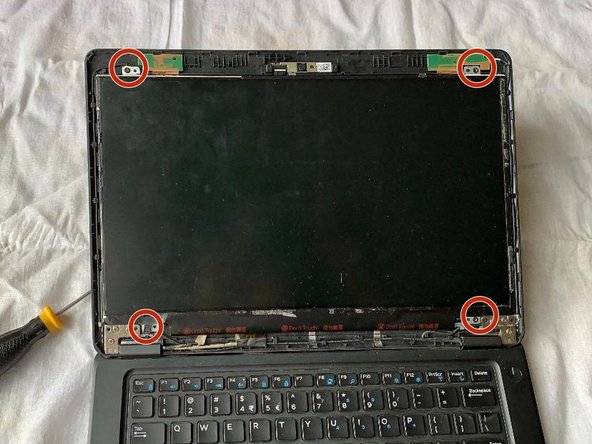

  12. Dell Latitude E5450-5450 LCD Screen Replacement: crwdns2935265:012crwdnd2935265:01crwdnd2935265:02crwdne2935265:0 Dell Latitude E5450-5450 LCD Screen Replacement: crwdns2935265:012crwdnd2935265:02crwdnd2935265:02crwdne2935265:0
    • Remove the plastic cover surrounding the screen.
    • Remove the four Phillips #0 screws from each corner of the laptop.

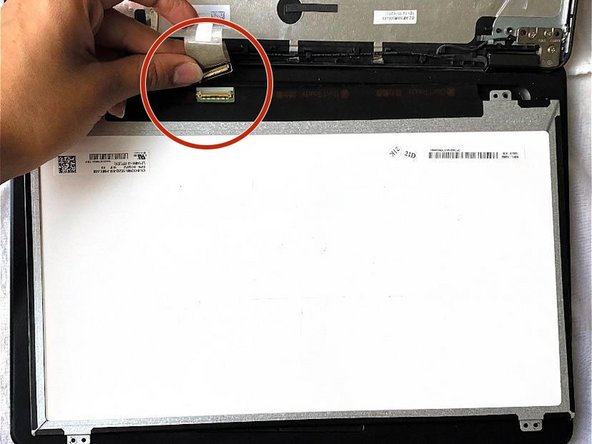

  13. Dell Latitude E5450-5450 LCD Screen Replacement: crwdns2935265:013crwdnd2935265:01crwdnd2935265:02crwdne2935265:0 Dell Latitude E5450-5450 LCD Screen Replacement: crwdns2935265:013crwdnd2935265:02crwdnd2935265:02crwdne2935265:0
    • Carefully put the screen upside down on the keyboard.
    • Disconnect the cable with the QR code on the opposite side of the screen.
