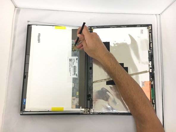

    • Use the spudger to move the sensor aside.
  7. Dell Latitude E5410 Screen Replacement: crwdns2935265:07crwdnd2935265:01crwdnd2935265:02crwdne2935265:0 Dell Latitude E5410 Screen Replacement: crwdns2935265:07crwdnd2935265:02crwdnd2935265:02crwdne2935265:0
    • Release the screen by pulling up and out.
