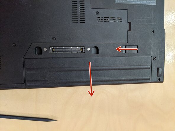

  1. Dell Latitude E5400 Hard Drive Replacement, Remove battery and access panel.: crwdns2935265:01crwdnd2935265:01crwdnd2935265:03crwdne2935265:0 Dell Latitude E5400 Hard Drive Replacement, Remove battery and access panel.: crwdns2935265:01crwdnd2935265:02crwdnd2935265:03crwdne2935265:0 Dell Latitude E5400 Hard Drive Replacement, Remove battery and access panel.: crwdns2935265:01crwdnd2935265:03crwdnd2935265:03crwdne2935265:0
    • Remove the battery and access panel from the computer.

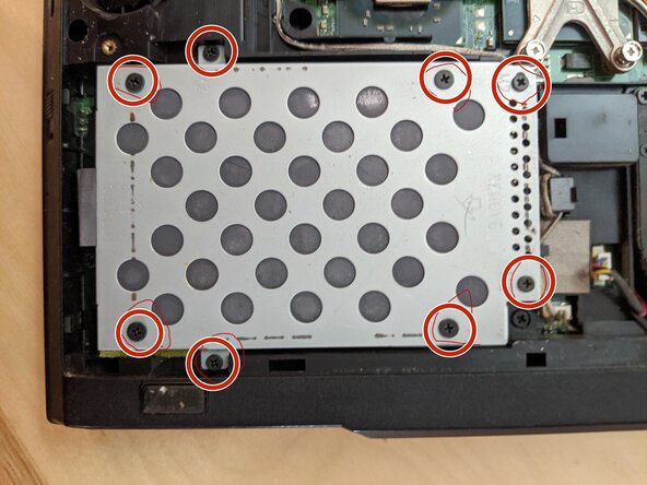

  2. Dell Latitude E5400 Hard Drive Replacement, Remove the four screws that secure the hard drive to the computer.: crwdns2935265:02crwdnd2935265:01crwdnd2935265:01crwdne2935265:0
    • Remove the eight screws that secure the hard drive to the computer.

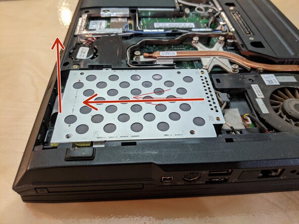

  3. Dell Latitude E5400 Hard Drive Replacement: crwdns2935265:03crwdnd2935265:01crwdnd2935265:01crwdne2935265:0
    • Disconnect the drive from the SATA connector by sliding it away, then pull the fabric strip up.

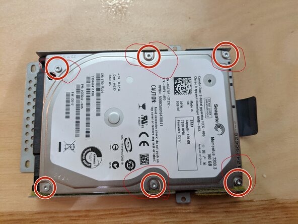

  4. Dell Latitude E5400 Hard Drive Replacement: crwdns2935265:04crwdnd2935265:01crwdnd2935265:01crwdne2935265:0
    • Remove the six screws securing the hard drive to the plate.
