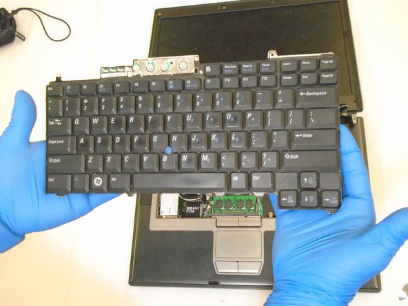

  8. Dell Latitude D830 RAM Replacement: crwdns2935265:08crwdnd2935265:01crwdnd2935265:01crwdne2935265:0
    • After removing the three screws, slide the keyboard out so the mainframe of it is loose.
    • There is still a component attached underneath.
  9. Dell Latitude D830 RAM Replacement: crwdns2935265:09crwdnd2935265:01crwdnd2935265:01crwdne2935265:0
    • The highlighted item should be the only component holding the keyboard.

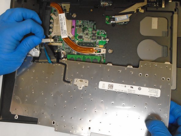

  10. Dell Latitude D830 RAM Replacement: crwdns2935265:010crwdnd2935265:01crwdnd2935265:03crwdne2935265:0 Dell Latitude D830 RAM Replacement: crwdns2935265:010crwdnd2935265:02crwdnd2935265:03crwdne2935265:0 Dell Latitude D830 RAM Replacement: crwdns2935265:010crwdnd2935265:03crwdnd2935265:03crwdne2935265:0
    • Where the highlighted rectangle is, there is a silver lever that you must push back.
    • Then where the highlighted circle is, you must take a spudger and push in.
    • This will then pop the white clip off, and the keyboard will be completely free.

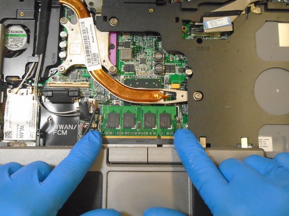

  12. Dell Latitude D830 RAM Replacement: crwdns2935265:012crwdnd2935265:01crwdnd2935265:02crwdne2935265:0 Dell Latitude D830 RAM Replacement: crwdns2935265:012crwdnd2935265:02crwdnd2935265:02crwdne2935265:0
    • The two clips highlighted are what hold the RAM in place.
    • Each of the clips should be pushed outward, freeing the RAM
    • The edge of the RAM that the arrow is pointing to should the be pulled, removing the RAM
