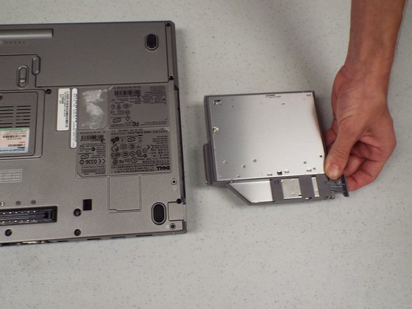

  3. Dell Latitude D820 Thermal Paste Replacement: crwdns2935265:03crwdnd2935265:01crwdnd2935265:03crwdne2935265:0 Dell Latitude D820 Thermal Paste Replacement: crwdns2935265:03crwdnd2935265:02crwdnd2935265:03crwdne2935265:0 Dell Latitude D820 Thermal Paste Replacement: crwdns2935265:03crwdnd2935265:03crwdnd2935265:03crwdne2935265:0

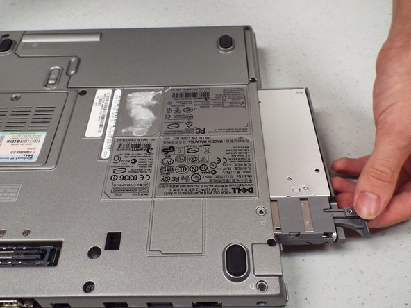

    • Remove the CD/DVD drive by pushing on the button under the drive.
    • There may be a little resistance pulling it out.

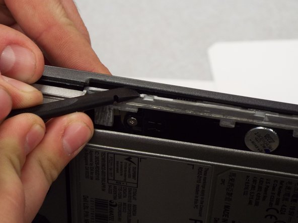

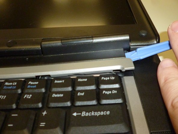

  5. Dell Latitude D820 Thermal Paste Replacement: crwdns2935265:05crwdnd2935265:01crwdnd2935265:02crwdne2935265:0 Dell Latitude D820 Thermal Paste Replacement: crwdns2935265:05crwdnd2935265:02crwdnd2935265:02crwdne2935265:0
    • Flip the laptop face up, making sure the screen is opened all the way and is flat.
    • Using an opening tool, carefully pry off the keyboard bezel keeping in mind wires are attached so do not pull too far or hard.

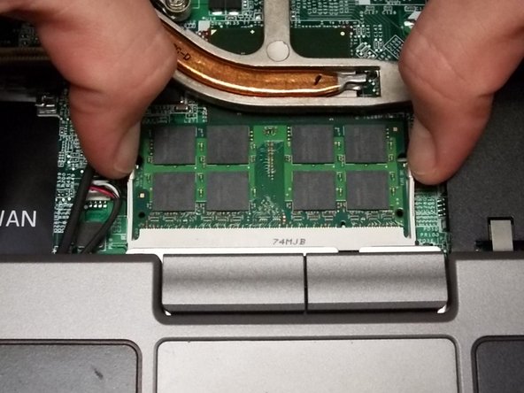

  7. Dell Latitude D820 Thermal Paste Replacement: crwdns2935265:07crwdnd2935265:01crwdnd2935265:03crwdne2935265:0 Dell Latitude D820 Thermal Paste Replacement: crwdns2935265:07crwdnd2935265:02crwdnd2935265:03crwdne2935265:0 Dell Latitude D820 Thermal Paste Replacement: crwdns2935265:07crwdnd2935265:03crwdnd2935265:03crwdne2935265:0
    • Remove the RAM stick under the keyboard by pulling the two tabs away from each other as shown in second picture.
    • Repeat for the second stick of RAM.

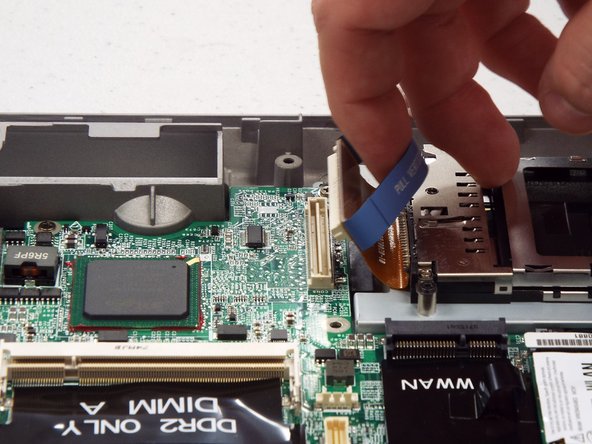

  9. Dell Latitude D820 Thermal Paste Replacement: crwdns2935265:09crwdnd2935265:01crwdnd2935265:01crwdne2935265:0
    • Remove the cable that connects the speaker to the frame by pulling straight out.
    • The cable is located to the left of DDR2 DIMM A.
    • Remove the cable that connects the track pad to the frame by pulling straight out.
    • The cable is also located to the left of DDR2 DIMM A.

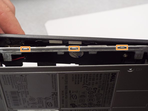

  10. Dell Latitude D820 Thermal Paste Replacement: crwdns2935265:010crwdnd2935265:01crwdnd2935265:03crwdne2935265:0 Dell Latitude D820 Thermal Paste Replacement: crwdns2935265:010crwdnd2935265:02crwdnd2935265:03crwdne2935265:0 Dell Latitude D820 Thermal Paste Replacement: crwdns2935265:010crwdnd2935265:03crwdnd2935265:03crwdne2935265:0
    • Remove three screws that hold the upper case to the motherboard.
    • Use a spudger to pry the three tabs by the CD-ROM to separate the upper and bottom casing.

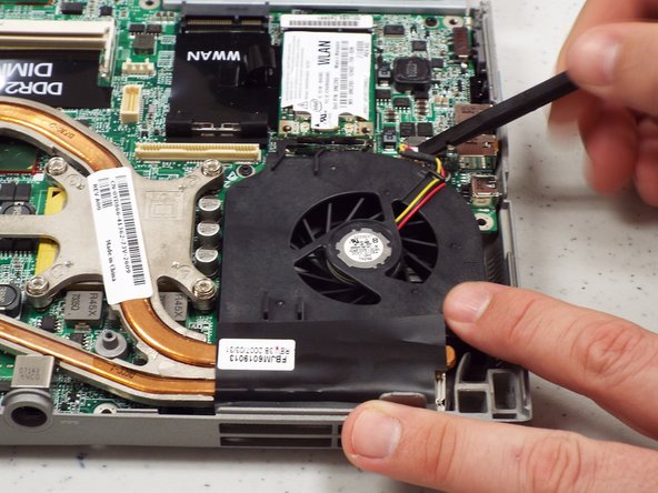

    • Remove two 5.6 mm screws from the fan.
    • Remove the fan power cable.
    • Loosen six captive spring loaded screws from the heat sink.

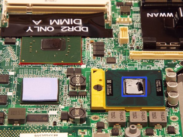

  13. Dell Latitude D820 Thermal Paste Replacement, Thermal Paste: crwdns2935265:013crwdnd2935265:01crwdnd2935265:02crwdne2935265:0 Dell Latitude D820 Thermal Paste Replacement, Thermal Paste: crwdns2935265:013crwdnd2935265:02crwdnd2935265:02crwdne2935265:0
    • Using a lint free cloth and a drop of TimClean or ArctiClean to clean residue from the heat sink.
    • Using a lint free cloth and a drop of TimClean or ArctiClean to clean residue off CPU.
    • Wipe with a clean lint free cloth to remove any residue of cleaner.
    • Do not touch with fingers!
    • Allow to dry completely.

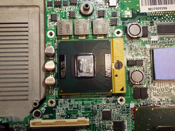

  14. Dell Latitude D820 Thermal Paste Replacement: crwdns2935265:014crwdnd2935265:01crwdnd2935265:02crwdne2935265:0 Dell Latitude D820 Thermal Paste Replacement: crwdns2935265:014crwdnd2935265:02crwdnd2935265:02crwdne2935265:0
    • Dispense a small amount of thermal paste onto processor.
    • Using your rubber finger stall or spudger spread a thin, even layer over processor.
    • The processor is ready for heat sink installation.
