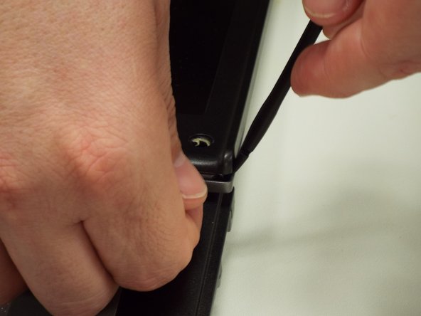

    • Open laptop lid and extend screen until it is parallel with the keyboard.
    • Locate the notch in the upper right corner of the keyboard (just above the 'page up' button).
    • Insert the plastic spudger and very gently lift the faceplate. It will make a soft snapping sound.
    • Set aside.

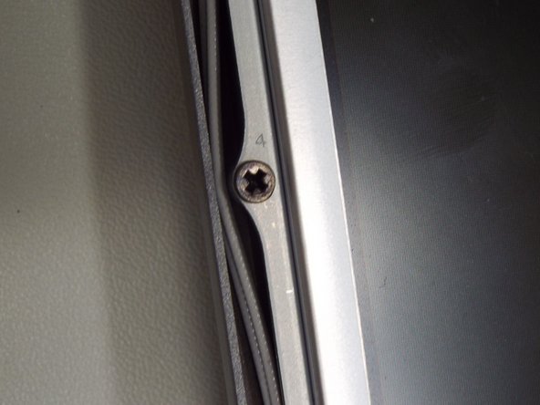

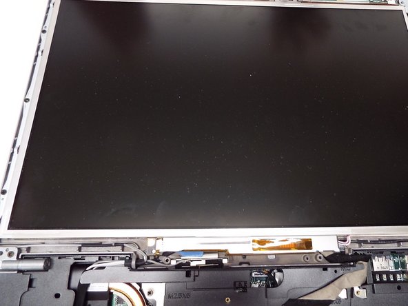

  6. Dell Latitude D820 Screen Replacement: crwdns2935265:06crwdnd2935265:01crwdnd2935265:03crwdne2935265:0 Dell Latitude D820 Screen Replacement: crwdns2935265:06crwdnd2935265:02crwdnd2935265:03crwdne2935265:0 Dell Latitude D820 Screen Replacement: crwdns2935265:06crwdnd2935265:03crwdnd2935265:03crwdne2935265:0
    • Locate the 8 numbered screws and remove in order. These philip head screws measure 5.70mm in length and 2.40mm in width
    • Gently lift screen being careful of the ribbon cables.

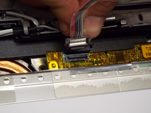

  7. Dell Latitude D820 Screen Replacement: crwdns2935265:07crwdnd2935265:01crwdnd2935265:02crwdne2935265:0 Dell Latitude D820 Screen Replacement: crwdns2935265:07crwdnd2935265:02crwdnd2935265:02crwdne2935265:0
    • The ribbon cable at the top of the screen uses a locking connector. Gently squeeze the levers on each side to release the lock and tug the ribbon cable down towards the bottom of the screen.
    • Set this connection aside.

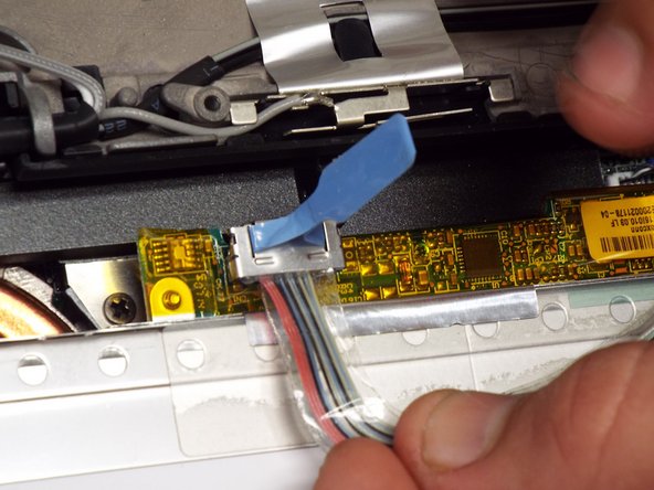

  8. Dell Latitude D820 Screen Replacement: crwdns2935265:08crwdnd2935265:01crwdnd2935265:03crwdne2935265:0 Dell Latitude D820 Screen Replacement: crwdns2935265:08crwdnd2935265:02crwdnd2935265:03crwdne2935265:0 Dell Latitude D820 Screen Replacement: crwdns2935265:08crwdnd2935265:03crwdnd2935265:03crwdne2935265:0
    • There is a small ribbon cable attached at the bottom of the screen also. Gently pull up on the blue tag to disconnect.
    • At this point remove the old display and connect the new one paying close attention to your finger placement to ensure you do not touch where the stickers say "DO NOT TOUCH".
