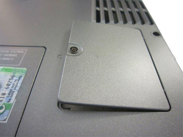

  4. Dell Latitude D610 Modem Replacement, Modem: crwdns2935265:04crwdnd2935265:01crwdnd2935265:03crwdne2935265:0 Dell Latitude D610 Modem Replacement, Modem: crwdns2935265:04crwdnd2935265:02crwdnd2935265:03crwdne2935265:0 Dell Latitude D610 Modem Replacement, Modem: crwdns2935265:04crwdnd2935265:03crwdnd2935265:03crwdne2935265:0
    • Remove the 3.9mm screw with a Philips #1 screwdriver containing the modem.
  5. Dell Latitude D610 Modem Replacement: crwdns2935265:05crwdnd2935265:01crwdnd2935265:02crwdne2935265:0 Dell Latitude D610 Modem Replacement: crwdns2935265:05crwdnd2935265:02crwdnd2935265:02crwdne2935265:0
    • Lift and remove the lid.

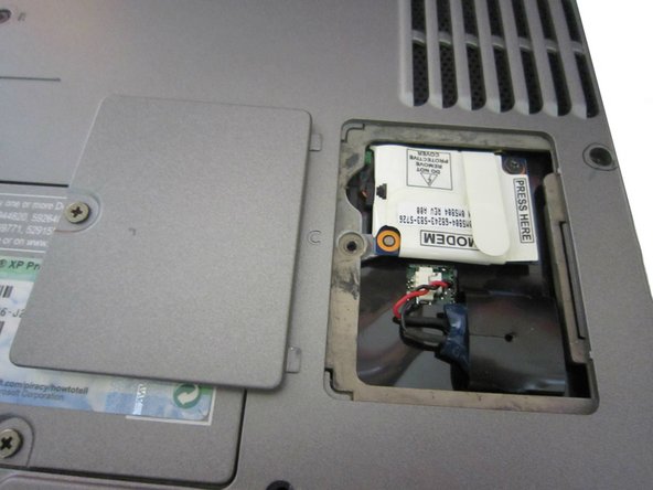

  6. Dell Latitude D610 Modem Replacement: crwdns2935265:06crwdnd2935265:01crwdnd2935265:02crwdne2935265:0 Dell Latitude D610 Modem Replacement: crwdns2935265:06crwdnd2935265:02crwdnd2935265:02crwdne2935265:0
    • Remove the 3.9mm Philips #1 screw on top of the modem.

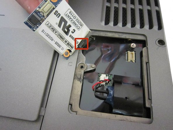

  7. Dell Latitude D610 Modem Replacement: crwdns2935265:07crwdnd2935265:01crwdnd2935265:03crwdne2935265:0 Dell Latitude D610 Modem Replacement: crwdns2935265:07crwdnd2935265:02crwdnd2935265:03crwdne2935265:0 Dell Latitude D610 Modem Replacement: crwdns2935265:07crwdnd2935265:03crwdnd2935265:03crwdne2935265:0
    • Pull on the white tab to remove the modem
    • Remove the cable going to the modem.
