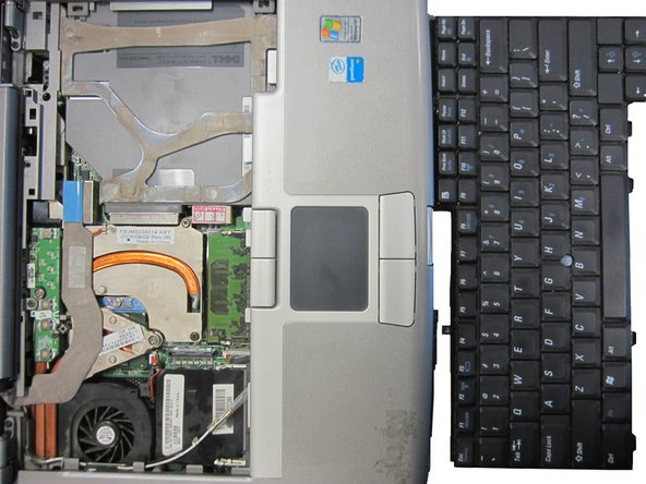

    • Using an opening tool, carefully release the keyboard from the case.
    • Making sure not to tear or damage the wires still connecting it to the laptop.
  7. Dell Latitude D610 Fan Replacement: crwdns2935265:07crwdnd2935265:01crwdnd2935265:03crwdne2935265:0 Dell Latitude D610 Fan Replacement: crwdns2935265:07crwdnd2935265:02crwdnd2935265:03crwdne2935265:0 Dell Latitude D610 Fan Replacement: crwdns2935265:07crwdnd2935265:03crwdnd2935265:03crwdne2935265:0
    • Carfully lift the key board.
    • Lift only about 3 - 4 inches so that the wires holding the keyboard do not get damaged.
    • Pull on the blue tab to unplug the keyboard.

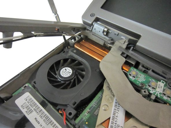

  8. Dell Latitude D610 Fan Replacement, Fan: crwdns2935265:08crwdnd2935265:01crwdnd2935265:02crwdne2935265:0 Dell Latitude D610 Fan Replacement, Fan: crwdns2935265:08crwdnd2935265:02crwdnd2935265:02crwdne2935265:0
    • Remove the two 3.9mm Philips #1 screws from the case.
  9. Dell Latitude D610 Fan Replacement: crwdns2935265:09crwdnd2935265:01crwdnd2935265:02crwdne2935265:0 Dell Latitude D610 Fan Replacement: crwdns2935265:09crwdnd2935265:02crwdnd2935265:02crwdne2935265:0
    • Remove the sixteen 3.9mm Philips #1 screws from the back.
  10. Dell Latitude D610 Fan Replacement: crwdns2935265:010crwdnd2935265:01crwdnd2935265:03crwdne2935265:0 Dell Latitude D610 Fan Replacement: crwdns2935265:010crwdnd2935265:02crwdnd2935265:03crwdne2935265:0 Dell Latitude D610 Fan Replacement: crwdns2935265:010crwdnd2935265:03crwdnd2935265:03crwdne2935265:0
    • Turn the computer over. Using an opening tool seperate the top cover from the rest of the frame.
    • Do not open the computer too widely or quickly. Doing so will result in damage to the computer.

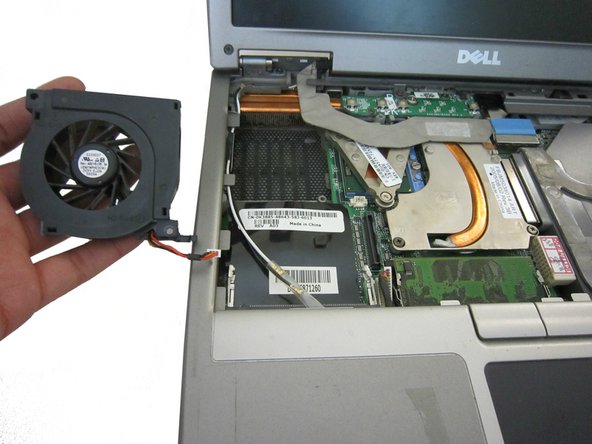

  11. Dell Latitude D610 Fan Replacement: crwdns2935265:011crwdnd2935265:01crwdnd2935265:03crwdne2935265:0 Dell Latitude D610 Fan Replacement: crwdns2935265:011crwdnd2935265:02crwdnd2935265:03crwdne2935265:0 Dell Latitude D610 Fan Replacement: crwdns2935265:011crwdnd2935265:03crwdnd2935265:03crwdne2935265:0
    • Remove the 3.9 mm Philips #1 screw.
    • Unplug the fan cable.
    • Lift fan out of compartment to remove the fan.
