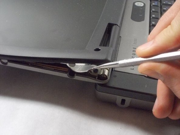

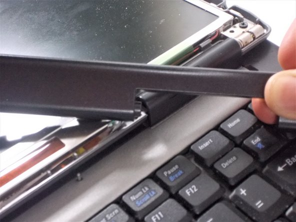

    • Use the spudger to pry the plastic border off.
    • Be sure that the plastic notch at the bottom of the screen is pulled out correctly. Pull the border to the left of the screen and out.

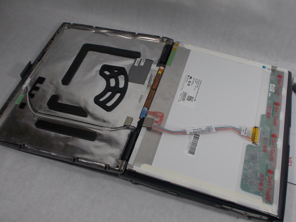

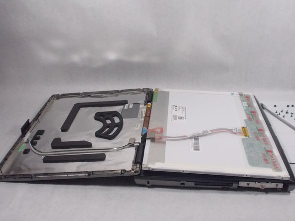

    • Lift the screen up and fold over gently.

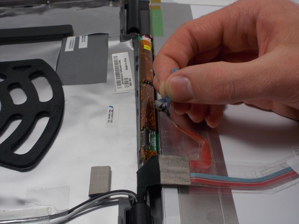

    • Pull on the blue tag sticking out at the bottom of the screen and disconnect the wire.
  8. Dell Latitude D530 Screen Replacement: crwdns2935265:08crwdnd2935265:01crwdnd2935265:03crwdne2935265:0 Dell Latitude D530 Screen Replacement: crwdns2935265:08crwdnd2935265:02crwdnd2935265:03crwdne2935265:0 Dell Latitude D530 Screen Replacement: crwdns2935265:08crwdnd2935265:03crwdnd2935265:03crwdne2935265:0
    • Towards the top of the screen on the back, unplug the “this side up” wire.
    • This can be done by squeezing the 2 metal side clips of the wire.
    • This could be difficult so wiggling the wire a little bit may be necessary.
