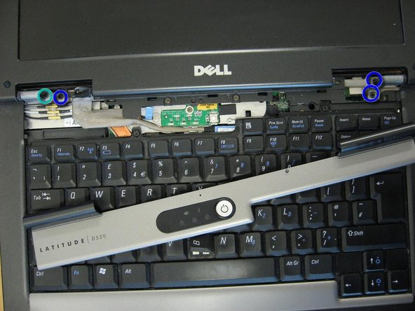

    • open laptop
    • with a small screwdriver carefully pry plastic cover
    • it helps to open the laptop all the way
    • be careful not to break these clips
    • The clips found under here were specially tricky

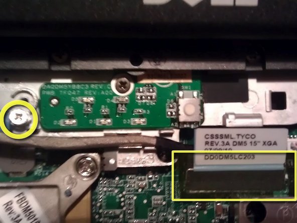

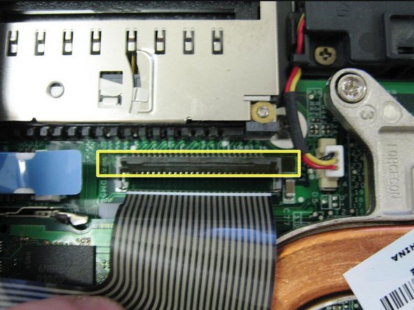

    • remove screws X 2
    • carefully lift keyboard, being careful not to damage the flat cable.
    • lift up tab to release flat cable and remove keyboard
  5. Dell Latitude D520 disassembly and power jack repair: crwdns2935265:05crwdnd2935265:01crwdnd2935265:03crwdne2935265:0 Dell Latitude D520 disassembly and power jack repair: crwdns2935265:05crwdnd2935265:02crwdnd2935265:03crwdne2935265:0 Dell Latitude D520 disassembly and power jack repair: crwdns2935265:05crwdnd2935265:03crwdnd2935265:03crwdne2935265:0
    • disconnect the three wires
    • disconnect video connector
    • remove ground screw
    • remove 3 screws
    • remove last screw, note this screw is longer then the other three
    • remove screen
