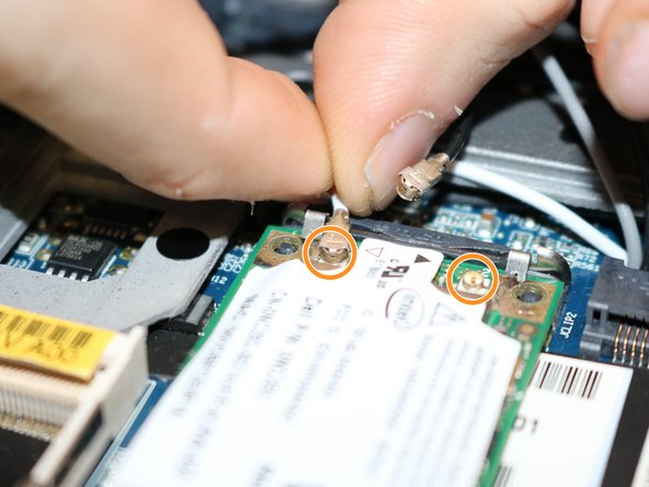

  4. Dell Latitude D430 Wireless Adapter Replacement: crwdns2935265:04crwdnd2935265:01crwdnd2935265:03crwdne2935265:0 Dell Latitude D430 Wireless Adapter Replacement: crwdns2935265:04crwdnd2935265:02crwdnd2935265:03crwdne2935265:0 Dell Latitude D430 Wireless Adapter Replacement: crwdns2935265:04crwdnd2935265:03crwdnd2935265:03crwdne2935265:0
    • Identify the two pins connecting the wireless adapter to the motherboard. (The wireless adapter will say WLAN on it.)
    • Carefully pull up on each pin and remove them from the wireless adapter.
    • Note that there are no wires/cables connecting the wireless adapter to the motherboard.
