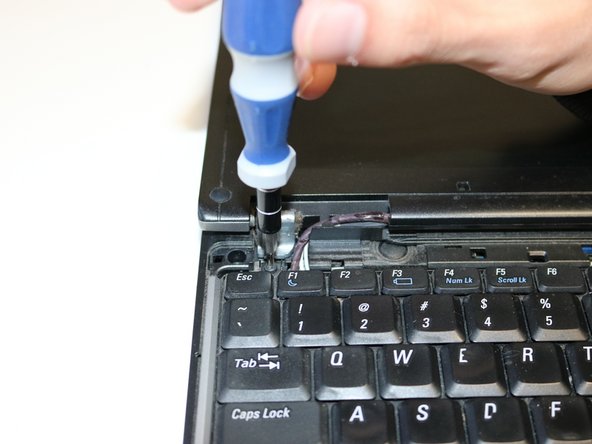

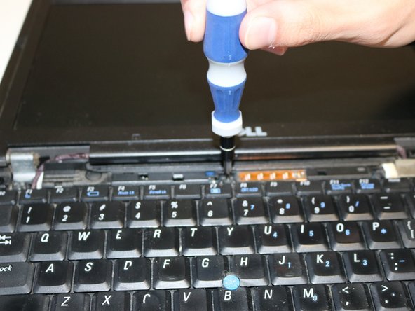

    • There are 3 screws that should be exposed now.
    • Use a Phillips 00 screwdriver to remove all 3 of the screws shown in the pictures.

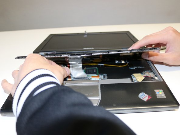

    • Gently lift the keyboard from the top.

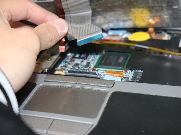

    • At the bottom of the keyboard, there will be ribbons connecting it to the motherboard. Be sure not to tear the ribbons.
    • Lift the clamps that are holding the ribbons in place in order to remove them. You should be able to remove the keyboard at this point.
