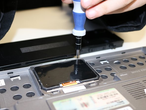

  5. Dell Latitude D430 Hard Drive Replacement, Hard Drive: crwdns2935265:05crwdnd2935265:01crwdnd2935265:03crwdne2935265:0 Dell Latitude D430 Hard Drive Replacement, Hard Drive: crwdns2935265:05crwdnd2935265:02crwdnd2935265:03crwdne2935265:0 Dell Latitude D430 Hard Drive Replacement, Hard Drive: crwdns2935265:05crwdnd2935265:03crwdnd2935265:03crwdne2935265:0
    • Remove the screws keeping the hard drive in place using a PH00 Philips screwdriver.
