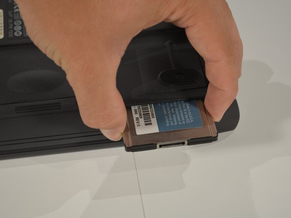

  3. Dell Latitude CP Teardown, PCMIA Card: crwdns2935265:03crwdnd2935265:01crwdnd2935265:02crwdne2935265:0 Dell Latitude CP Teardown, PCMIA Card: crwdns2935265:03crwdnd2935265:02crwdnd2935265:02crwdne2935265:0
    • Push on the button next to the slot your card is in till and it will pop out. Push in on it again to pop out the actual card.

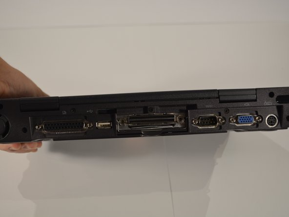

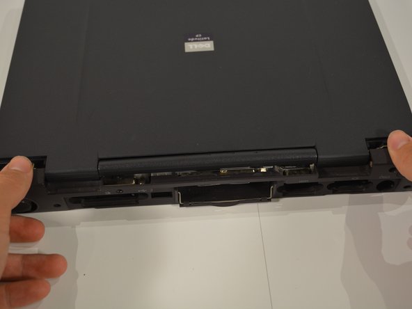

  5. Dell Latitude CP Teardown, Back IO Panel: crwdns2935265:05crwdnd2935265:01crwdnd2935265:03crwdne2935265:0 Dell Latitude CP Teardown, Back IO Panel: crwdns2935265:05crwdnd2935265:02crwdnd2935265:03crwdne2935265:0 Dell Latitude CP Teardown, Back IO Panel: crwdns2935265:05crwdnd2935265:03crwdnd2935265:03crwdne2935265:0
    • Unscrew the five screws along the bottom of the laptop, then remove another seven screws along the back of the laptop, then simply pull off the IO cover.
    • Five 5mm Screws

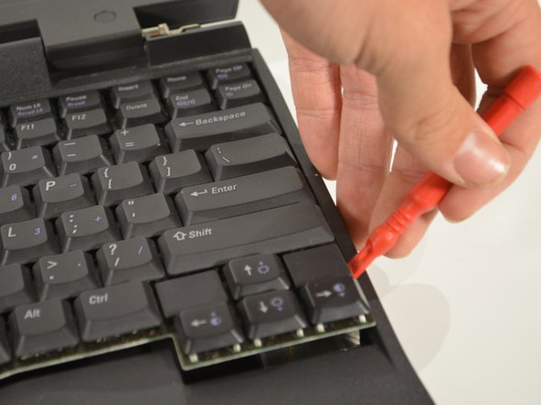

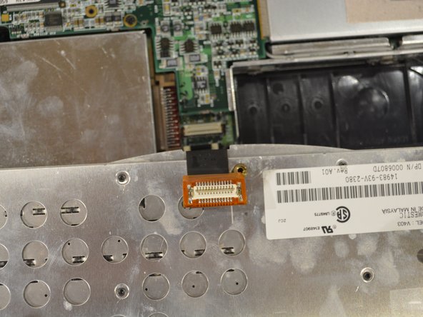

  7. Dell Latitude CP Teardown, Keyboard: crwdns2935265:07crwdnd2935265:01crwdnd2935265:02crwdne2935265:0 Dell Latitude CP Teardown, Keyboard: crwdns2935265:07crwdnd2935265:02crwdnd2935265:02crwdne2935265:0
    • Use a plastic pry tool or a small flat-head screw driver to gently pry up on the left side of the keyboard until it pops up. Do the same for the right side, and slowly lift up the keyboard.
  8. Dell Latitude CP Teardown, Keyboard Ribbon Cable: crwdns2935265:08crwdnd2935265:01crwdnd2935265:02crwdne2935265:0 Dell Latitude CP Teardown, Keyboard Ribbon Cable: crwdns2935265:08crwdnd2935265:02crwdnd2935265:02crwdne2935265:0
    • Use a plastic pry too of a small flat-head screwdriver to VERY gently pry on the keyboard cable connector on it pops off.

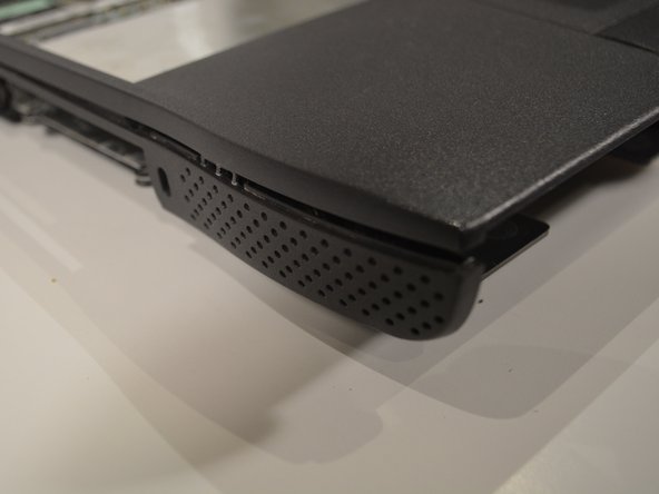

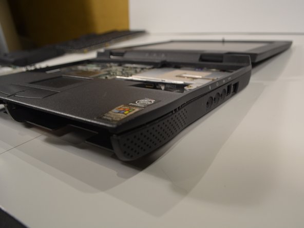

  10. Dell Latitude CP Teardown, Palmrest: crwdns2935265:010crwdnd2935265:01crwdnd2935265:03crwdne2935265:0 Dell Latitude CP Teardown, Palmrest: crwdns2935265:010crwdnd2935265:02crwdnd2935265:03crwdne2935265:0 Dell Latitude CP Teardown, Palmrest: crwdns2935265:010crwdnd2935265:03crwdnd2935265:03crwdne2935265:0
    • There is one screw to remove that is holding on the palm rest. Pop up both sides of the palm rest. They may be very tough to pull off, but they shouldn't break.
    • One 5mm Screw

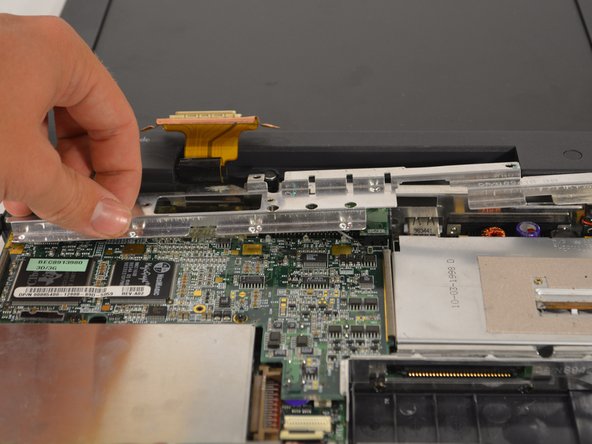

  12. Dell Latitude CP Teardown, IO Shield: crwdns2935265:012crwdnd2935265:01crwdnd2935265:02crwdne2935265:0 Dell Latitude CP Teardown, IO Shield: crwdns2935265:012crwdnd2935265:02crwdnd2935265:02crwdne2935265:0
    • Remove the four screws holding the IO shield, and pull up and to the right to remove it.
    • Four 5mm Screws

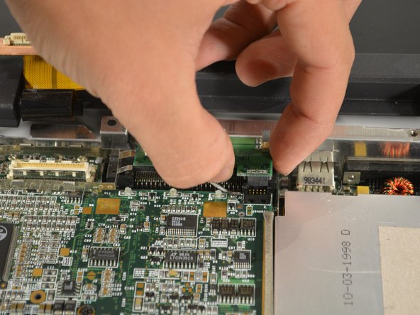

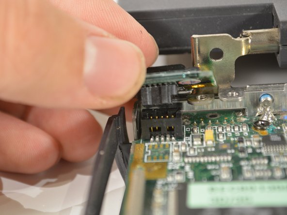

  13. Dell Latitude CP Teardown, IR Blaster: crwdns2935265:013crwdnd2935265:01crwdnd2935265:02crwdne2935265:0 Dell Latitude CP Teardown, IR Blaster: crwdns2935265:013crwdnd2935265:02crwdnd2935265:02crwdne2935265:0
    • Remove the screw holding it on and pull up on the IR blaster till it disconnects.
    • One 5mm Screw

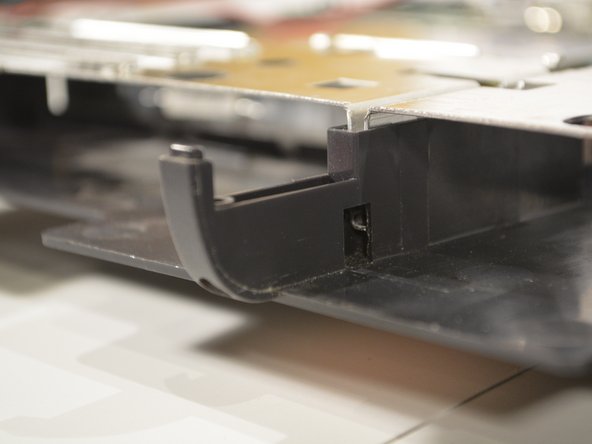

    • Remove the speaker wire from bottom bracket holdings and bend it out of the way to remove the bottom case bracket.

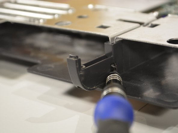

  17. Dell Latitude CP Teardown, Bottom Case Bracket: crwdns2935265:017crwdnd2935265:01crwdnd2935265:03crwdne2935265:0 Dell Latitude CP Teardown, Bottom Case Bracket: crwdns2935265:017crwdnd2935265:02crwdnd2935265:03crwdne2935265:0 Dell Latitude CP Teardown, Bottom Case Bracket: crwdns2935265:017crwdnd2935265:03crwdnd2935265:03crwdne2935265:0
    • There are two screws on either side of the bracket to remove. You need use a small screwdriver to push up on a plastic clip on the middle of the bracket.
    • Four 5mm Screws

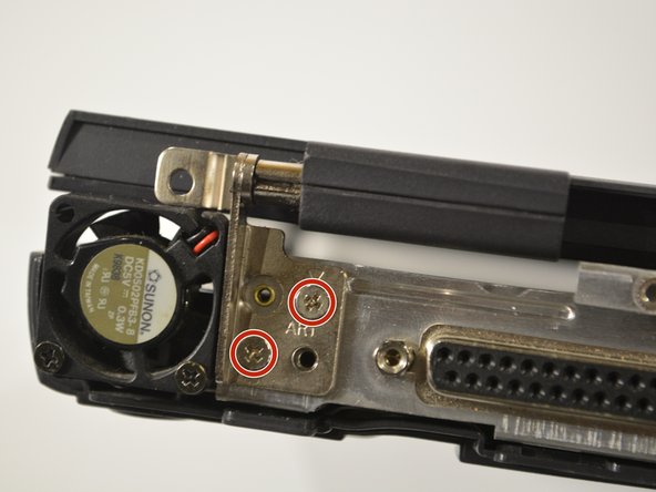

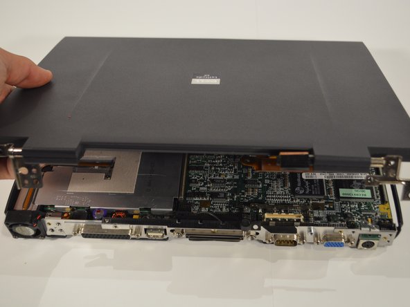

  19. Dell Latitude CP Teardown, LCD Hinges: crwdns2935265:019crwdnd2935265:01crwdnd2935265:03crwdne2935265:0 Dell Latitude CP Teardown, LCD Hinges: crwdns2935265:019crwdnd2935265:02crwdnd2935265:03crwdne2935265:0 Dell Latitude CP Teardown, LCD Hinges: crwdns2935265:019crwdnd2935265:03crwdnd2935265:03crwdne2935265:0
    • There are two screws on each hinge, remove them and take off the whole LCD assembly.
    • Four 5mm screws

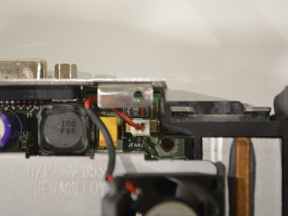

  20. Dell Latitude CP Teardown, Fan: crwdns2935265:020crwdnd2935265:01crwdnd2935265:02crwdne2935265:0 Dell Latitude CP Teardown, Fan: crwdns2935265:020crwdnd2935265:02crwdnd2935265:02crwdne2935265:0
    • Remove the two screws holding the fan in, and disconnect the fan connector using your fingernails.

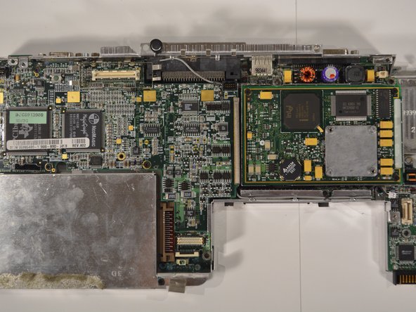

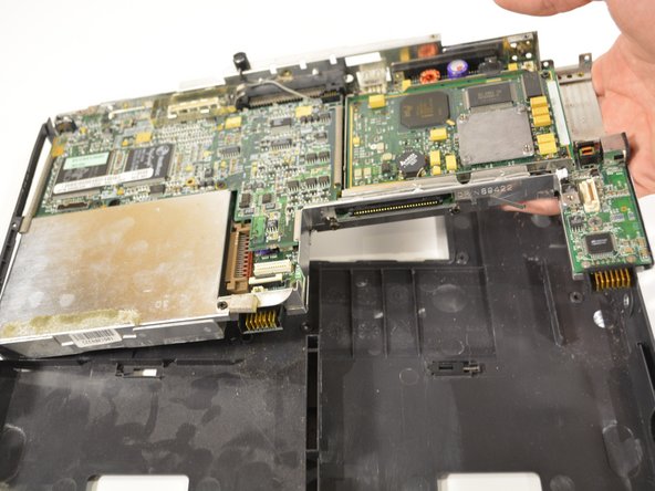

  22. Dell Latitude CP Teardown, System Board Assembly: crwdns2935265:022crwdnd2935265:01crwdnd2935265:03crwdne2935265:0 Dell Latitude CP Teardown, System Board Assembly: crwdns2935265:022crwdnd2935265:02crwdnd2935265:03crwdne2935265:0 Dell Latitude CP Teardown, System Board Assembly: crwdns2935265:022crwdnd2935265:03crwdnd2935265:03crwdne2935265:0
    • There is one screw to remove, then you can lift out the entire board by lifting up on the right side, and pulling out to the right.
    • One 5mm Screw
