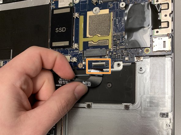

  13. Dell Latitude 9510 Motherboard Replacement: crwdns2935265:013crwdnd2935265:01crwdnd2935265:02crwdne2935265:0 Dell Latitude 9510 Motherboard Replacement: crwdns2935265:013crwdnd2935265:02crwdnd2935265:02crwdne2935265:0
    • Flip up the small metal display cable clip, until the clip is parallel to the ribbon cable, then pull it directly backwards until it releases.
    • Flip up the lock-bar on the ZIF connector, then gently pull the ribbon cable until it releases.
    • This requires almost no force.
