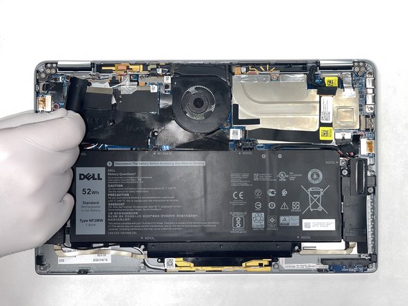

  4. Dell Latitude 9410 2-in-1 Wi-Fi Card Replacement, Wi-Fi Card: crwdns2935265:04crwdnd2935265:01crwdnd2935265:02crwdne2935265:0 Dell Latitude 9410 2-in-1 Wi-Fi Card Replacement, Wi-Fi Card: crwdns2935265:04crwdnd2935265:02crwdnd2935265:02crwdne2935265:0
    • Remove the protective film located at the top left corner of the motherboard.

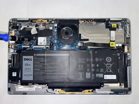

  5. Dell Latitude 9410 2-in-1 Wi-Fi Card Replacement: crwdns2935265:05crwdnd2935265:01crwdnd2935265:02crwdne2935265:0 Dell Latitude 9410 2-in-1 Wi-Fi Card Replacement: crwdns2935265:05crwdnd2935265:02crwdnd2935265:02crwdne2935265:0
    • Use a Philips #00 screwdriver to remove the 2mm screw located above the wifi card.
  6. Dell Latitude 9410 2-in-1 Wi-Fi Card Replacement: crwdns2935265:06crwdnd2935265:01crwdnd2935265:01crwdne2935265:0
    • Remove the black and white wires located above the wifi card using a blue, plastic spudger.
  7. Dell Latitude 9410 2-in-1 Wi-Fi Card Replacement: crwdns2935265:07crwdnd2935265:01crwdnd2935265:01crwdne2935265:0
    • Remove the Wifi card from its slot in the motherboard.
